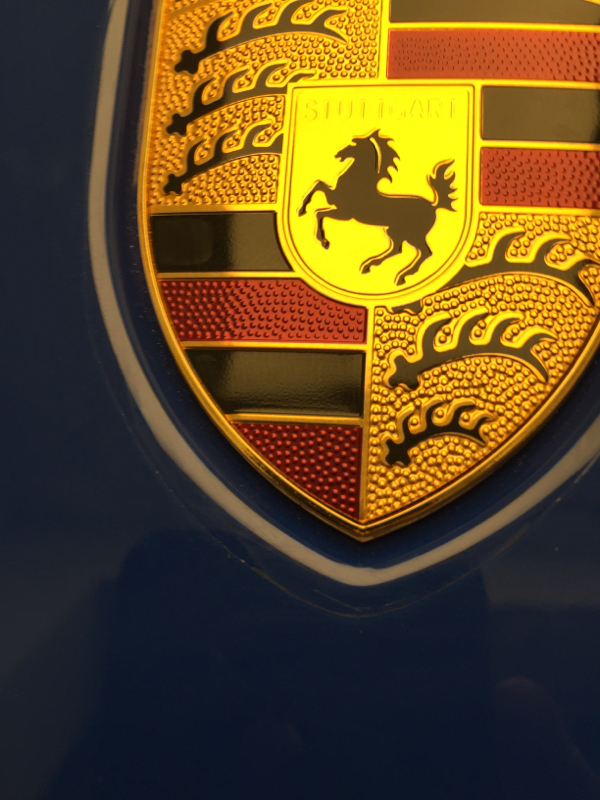

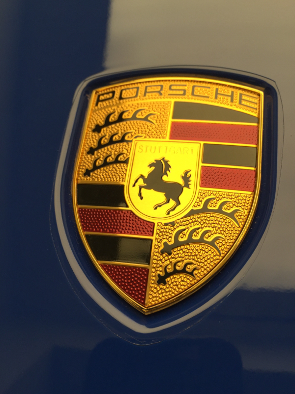

Front Hood Name:  image-3951138059.jpg
Size:  526.9 KB There is a cut around the crest,
and it is crooked Razor blade cuts in paint
Cut wrap at side of hood, close to seam on each side

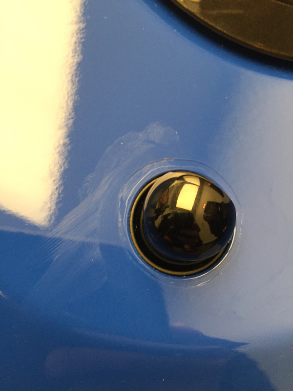

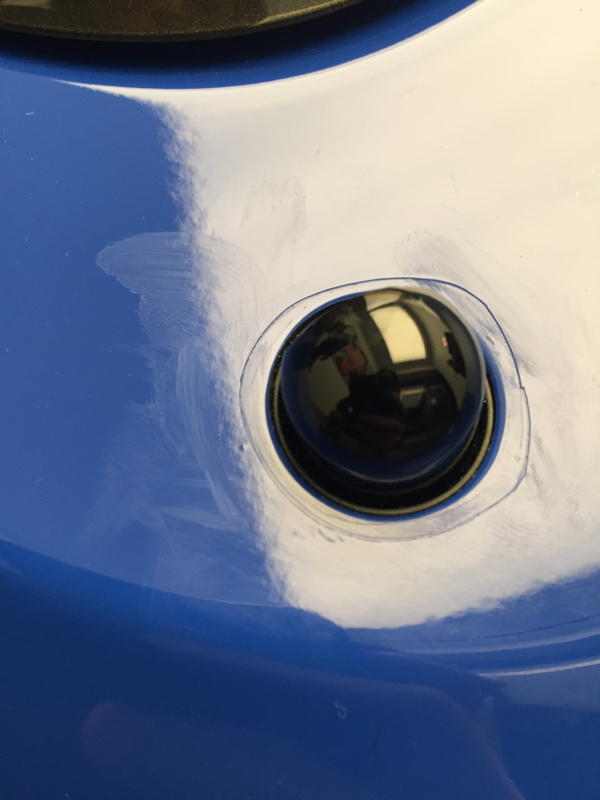

Front Bumper Name:  image-874705718.jpg
Size:  394.7 KB Name:  image-615431733.jpg
Openings for headlight washers are by an epileptic
Razor blade cuts within

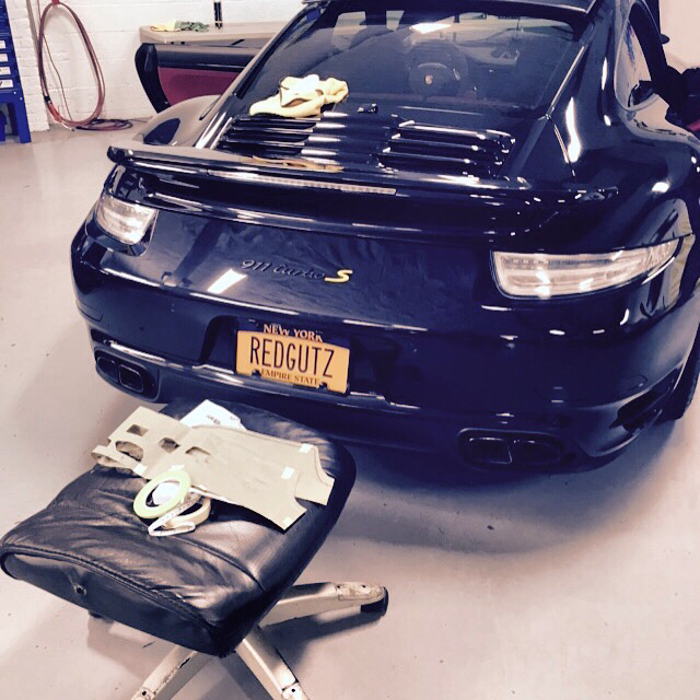

By the way the proper technique for rear badging Xpel is to remove the original badging. Put Xpel over the entire body panel/bumper and then install new badging. This way NO cut lines.
Here is my car in the middle of a rear bumper Xpel Job and after at Detailing Dynamics (had to have rear bumper Xpel replaced when someone backed into my car during Goldrush Rally 7 -- XPel was only thing damaged as person backed into the car at about 1-2 mph
