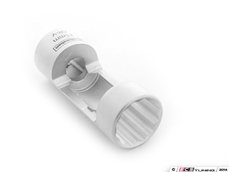

Perhaps the shop crew didn't look closely at the top of the front or rear strut assembly to notice a large plastic clip that you simply disconnect to release the cable? Perhaps they didn't have the proper strut nut socket (I believe it is a 21mm) to remove the strut nut without binding the cable? That's a $15 socket you can purchase from ECS Tuning.

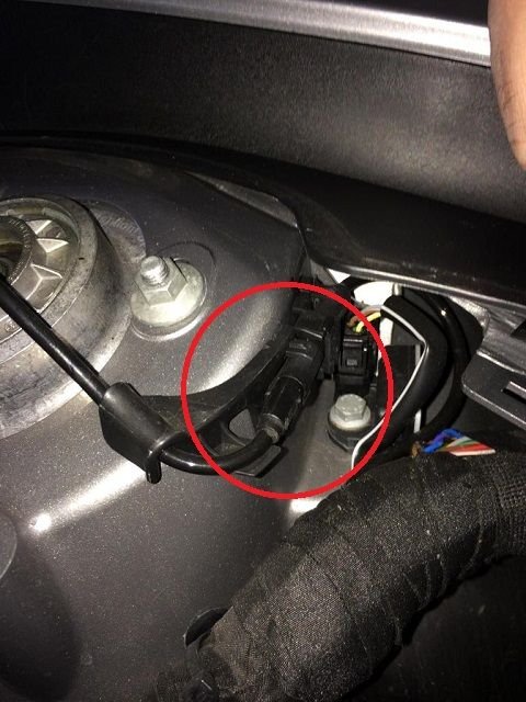

Here's a few pictures from my own C4S when I was removing the front springs.... You can see just how "easy" it is to unclip the PASM cable and remove the strut nuts without having to worry at all about the cable! Nothing electronic up here, just a cable.
1. Locate PASM cable connector...
2. Pull PASM cable connector apart....
3. Use strut nut socket to remove strut nut without damaging the PASM cable.
