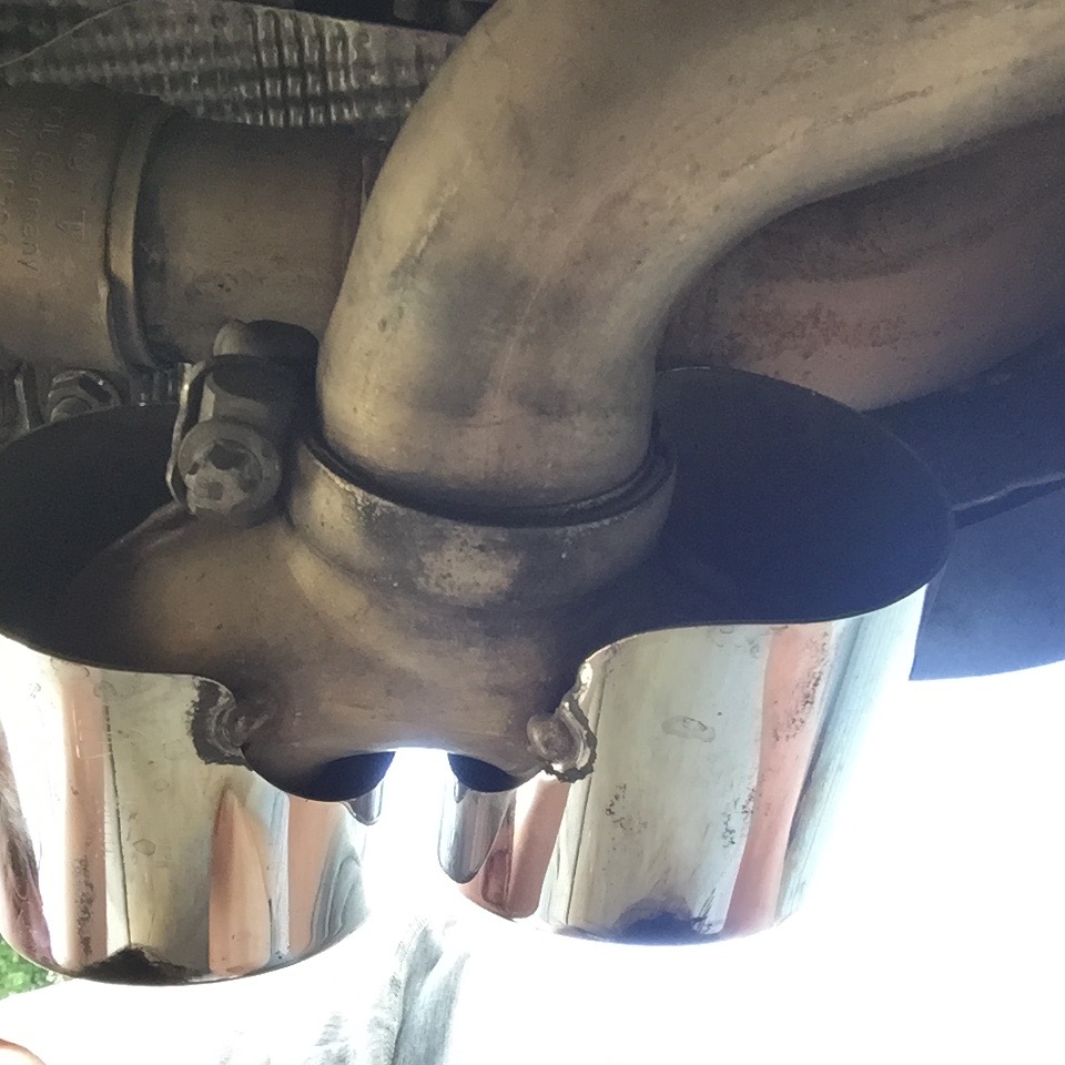

This is what my car looks like now. It has 4 tips (factory option XLT), but each set of tips has only one exhaust inlet. Looks like the tips on the PSE have 2 inlets and 2 outlets, so each tip essentially has a discrete exhaust pipe feeding it. If that is the case, my existing tips won't work. Bummer.

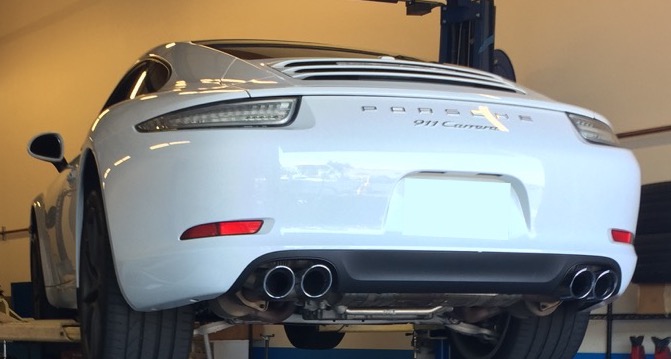

Just did my car 3.8L PSE install/retrofit. Was easy to do..dealer did it and ordered parts needed. Did not order the full kit from Suncoast as I was upgrading to an aftermarket exhaust. Basically if you order the kit from Suncoast you get everything you need to do PSE including the exhaust. Otherwise you can do the parts yourself and install whatever exhaust you want as there are options out there which are better than PSE.

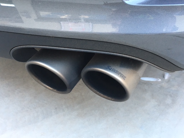

Thanks for the thoughtful response. I will check out some of those options. However, some of them are out of my comfort zone price-wise. Just don't want to spend that much. That said, if I was willing to spend the money, the Akrapovic looks like a beautifully made product!
