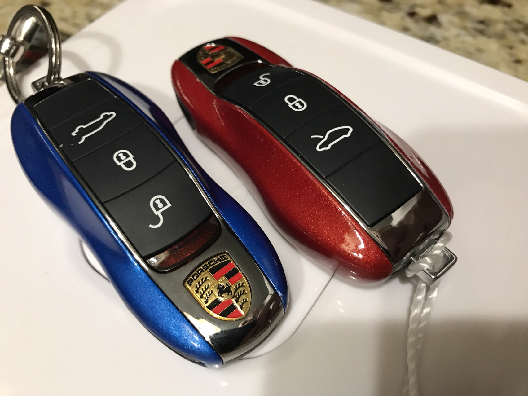

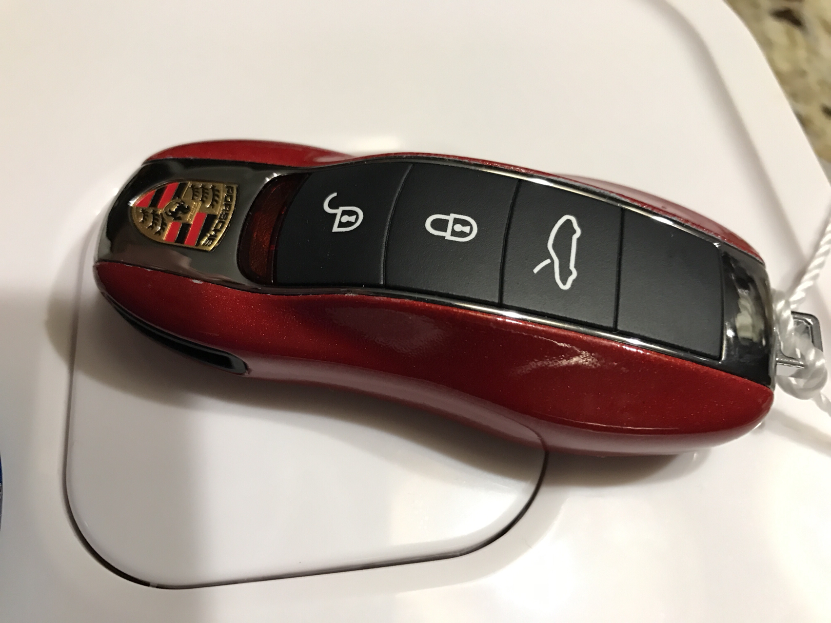

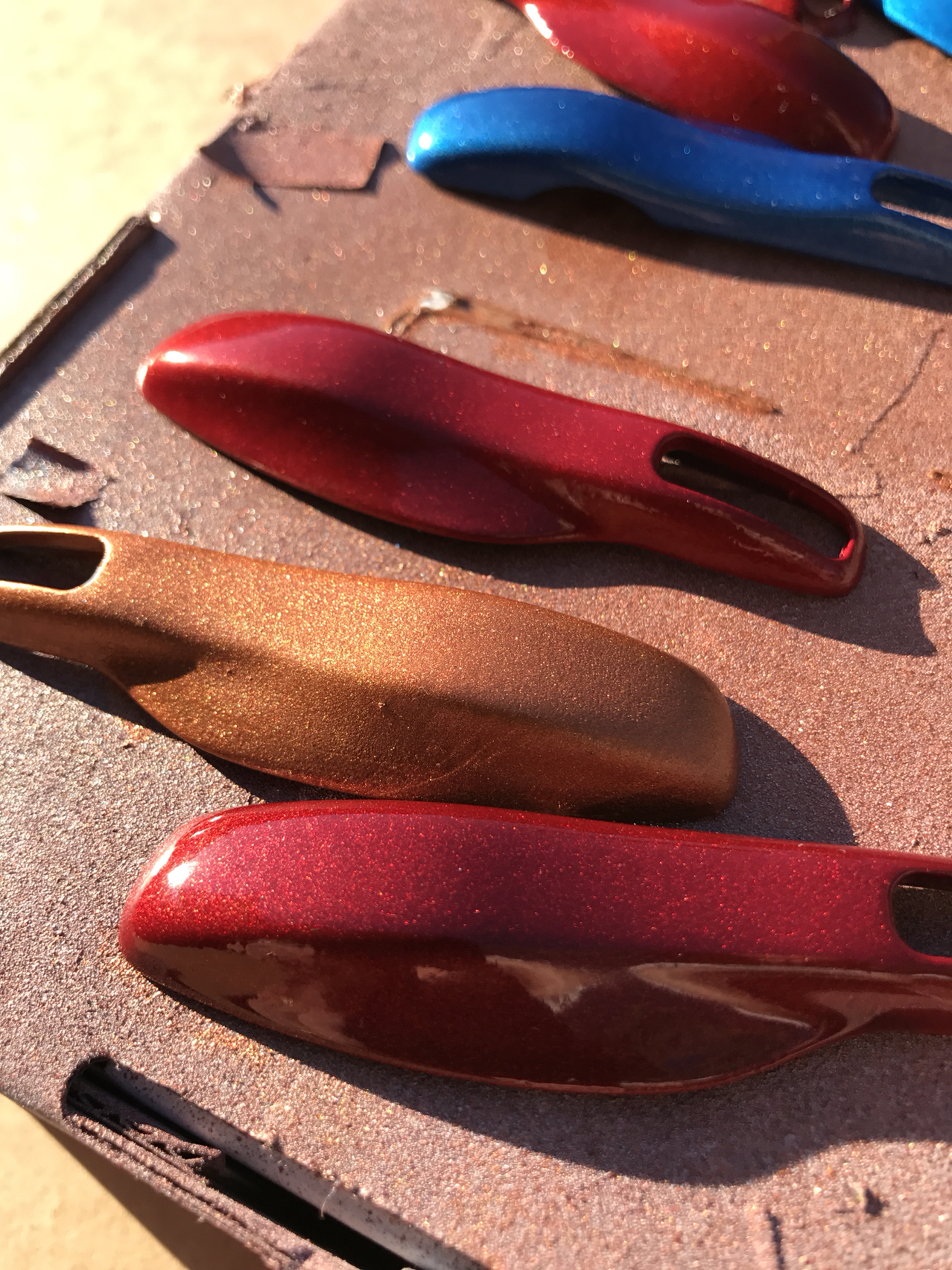

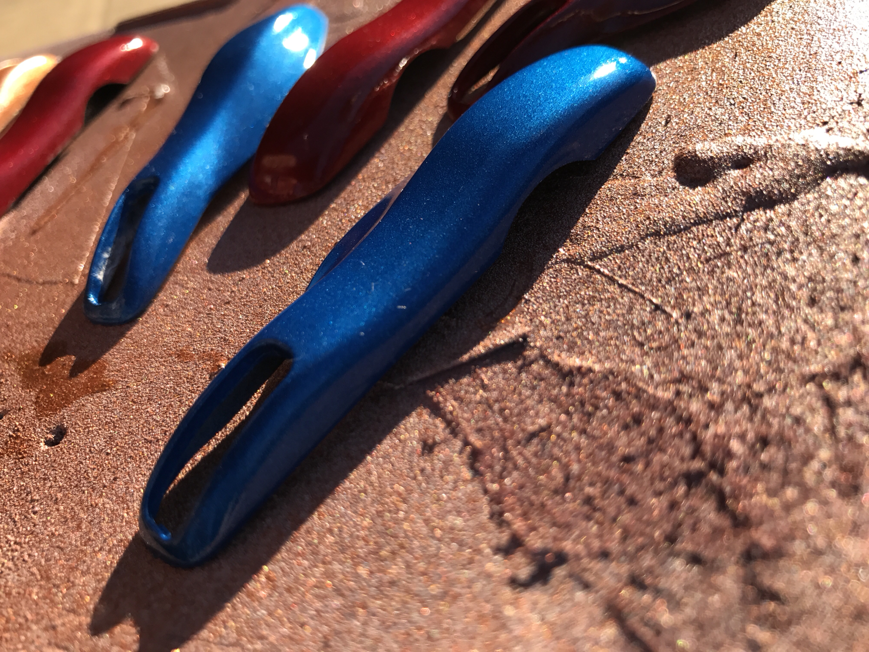

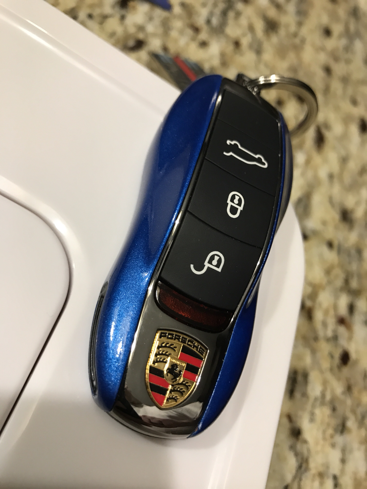

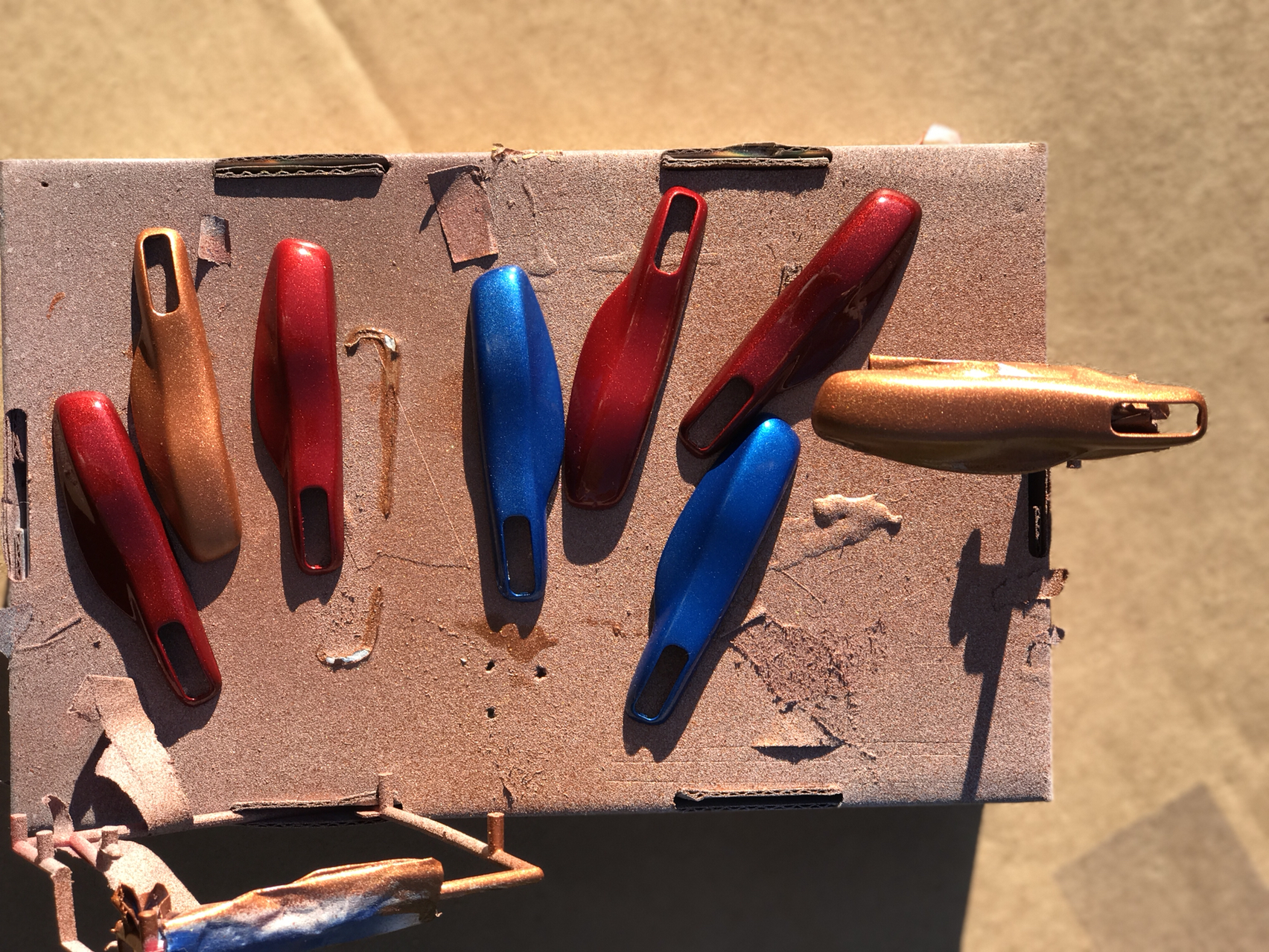

Quick diy for the bored ones. Mine and hers keys as they dry and the final product
All acrylic from tamiya. Prefer spray to airbrush, the former can be rather runny against the primer. Follow label instructions
White prime, 2 thin layers
Wait 10-15 mins
Acrylic paint, 4 layers increasing thickness towards the end, around 5 mins apart
Wait 10 mins
3-4 layers of acrylic lacquer, thin coats going to medium at the end. I used fast dry, can touch in about 10 mins
Given multiple layers, I left in the sun two days in a row, retrieving at night to avoid condensation
I avoided enamel paint given it needs time to cure rather than dry, can easily leave a tacky finish, dust magnet. The copper one I added another layer to even things a bit.
Total cost, about $15 per key, likely less. Clear advantage to choose whatever color you want and save some bucks...
I also did the start **** in mica red, similar steps
Next, the rear apron...
Cheers!
