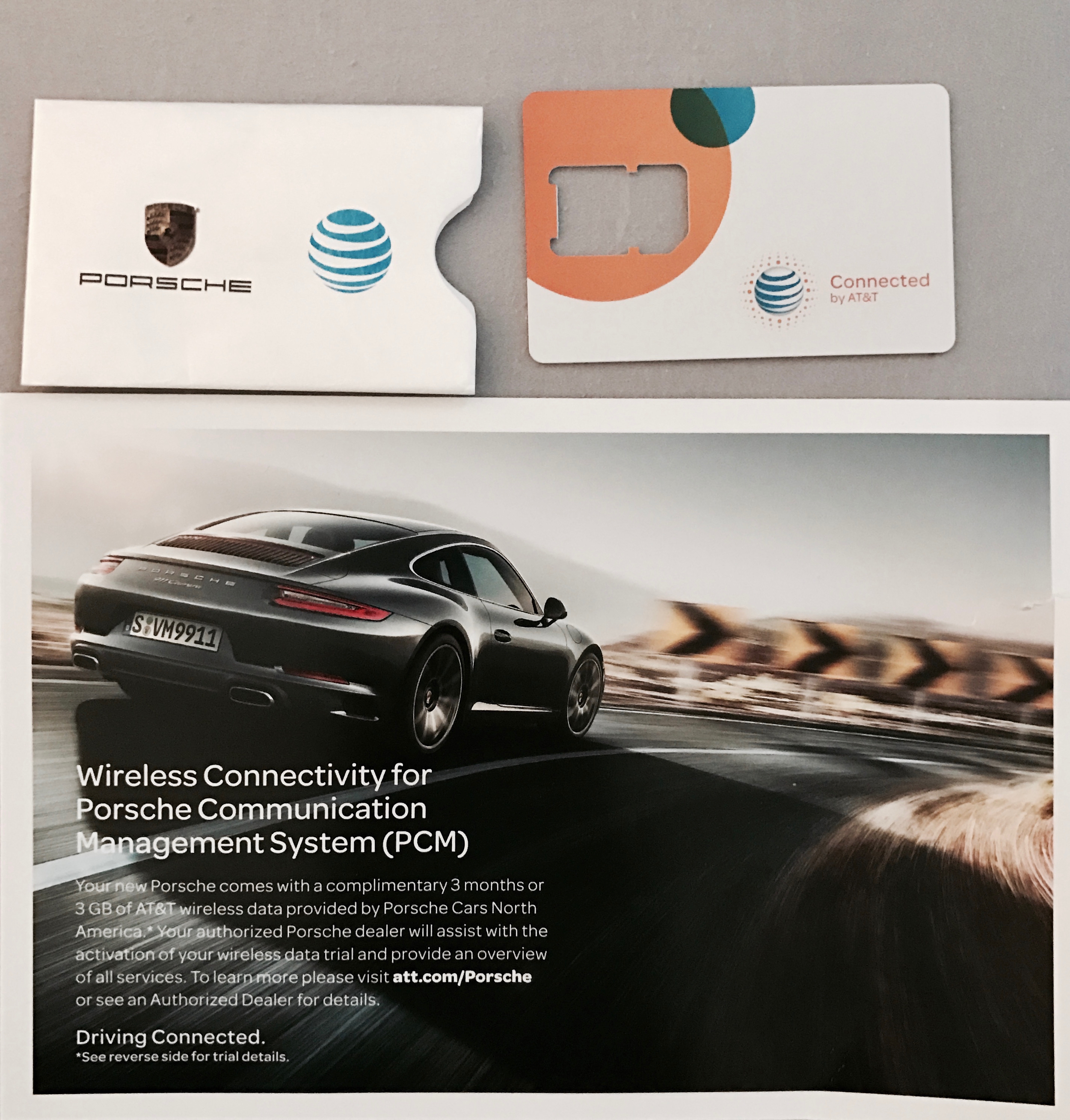

Originally Posted by drspeed
Dealer is giving me the actual SIM. I already signed up for the service and have the car activated at the dealer earlier. I believe I now need to take the number off the Sim card they give me and register it online at the ATT Porsche connect website. I'll confirm when it's done.
DRP
Got the card from the dealer (below). Then went to the web to register it. All set - for 90 days....
Google maps works now w/real time traffic etc... The Porsche apps on the PCM still require that I open the iPhone app first I believe.
This is all relatively infant tech. It's not worth the hassle IMHO to use, but I want to try it out first to confirm that suspicion.
