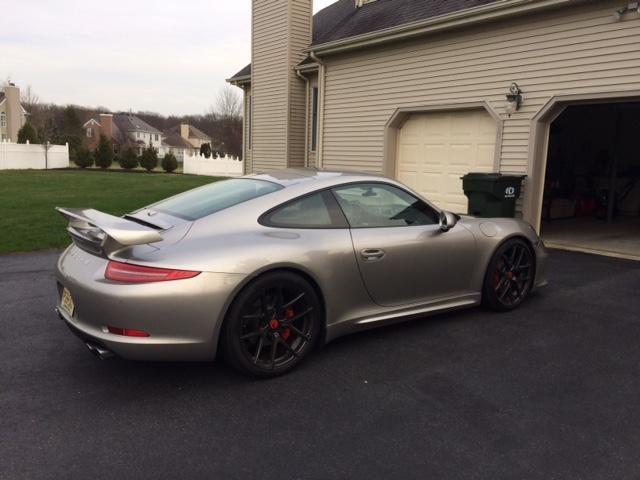

Hi,
I had the techart type 2 wing and installed it myself. The only thing you need to do is get it painted by reputable shop and then after you install take to Porsche dealer to have spoiler button deactivated. This will take 1 hr of shop time.

^Thanks for that info Dknj23! I just was at the dealer asking about the installation of this piece (when mine arrives), as I was curious on the factory spoiler being deactivated once the wing is installed, which is why I'd planned on letting the dealer install. Do you have any pictures of the wing on your car or impressions? It appears there are 2 heights of the wing from various pictures I've seen but can't confirm this. Pictures below of it low and just over the engine area, and another with it 8-10" higher.

yes, there are 2 positions based on whether or not you have coupe or convertible.
the lower of the 2 positions is for convertible - it has to do with aerodynamic differences
between coupe and convertible.
here is my former car with the techart package.

Looks perfect, thanks! Great to see more realistic photos than the professional ones sometimes. Of all things, minutes after I last posted FedEx freight arrived to my office with the TechArt wing. Hopefully can get it on after the holidays! Thanks for sharing and the info on the height differences. I didn't really think about the aero difference between coupe/cabrio
