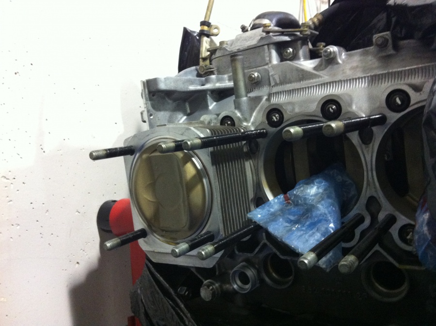

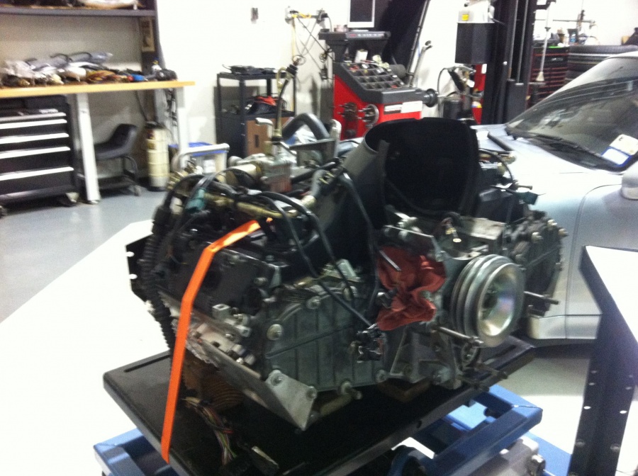

Had a small time consuming issue. There had to be about .0625" pockets ground out of the inside piston skirts. Since I stayed 3.6 the Pauter rods were a little large for the rotation. Something I guess uncommon since most of these builds go 3.8. Then the situation is a nonevent since the inside diameter on the 3.8 piston is slightly larger. Well here is a picture of the last phase before the heads get put back on.

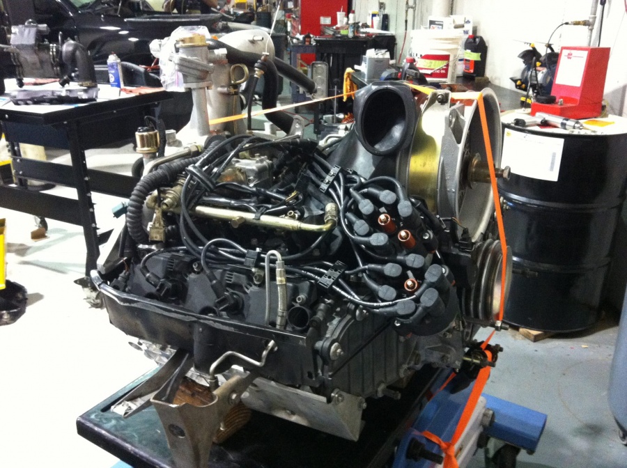

more good stuff for your eyes guys!
A few pics of the last phases. I sent alot of parts from the engine bay out to be high temp coated red like the brakes. The alternator fan as well as the intercooler cover to be the "Big Red" Just little touches to set it off. Maybe see a bit of color through the whale tail.

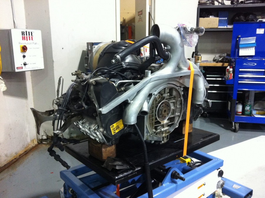

and...
different angles
