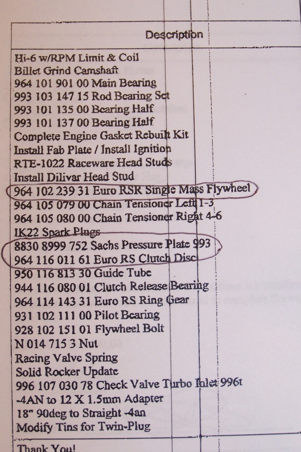

Al, I need some advice on a clutch, What are you running. Seems to have all of the clutch tuners running for a loop when we say 993.
This time wasting, nickel and diming, last stage and we need a good clutch.
I spoke with the guys at andial today. Gave them a peek at the build sheet in the beginning of the post, They said the only thing they had was a track car setup that would suffice. That setup he said was not streetable.
Chris,
Mine is a hybrid setup with a 964 Euro RSR single mass flywheel mated to an uprated Sachs 964 Euro RS clutch disc with a Sachs 993 pressure plate, assembled by Protosport in NJ-see their item sheet on the attachment. It is rated to handle well north of 650 lb-ft and hasn't slipped in 30,000 miles, including 50 track days at Watkins Glen. I would ask Todd at Protomotive where you could source the hardware if your installer can't. And my setup is very streetable-it literally feels no different than stock. John and Paul at Protosport simply do great work. The other option is triple carbon.
Al

Todd
I spoke with Todd, he sourced everything and its on the way. He said we are going to go with an RSR Lightweight flywheel and a sachs 764 997.2 GT2 RS disc/slave setup. Right now he has it in a few cars that are recent builds. Just like you said it is a hybrid build of matching dimensionally porsche parts. They do after all... Build race cars This setup is currently holding 970 wtq in one of his cars that he built this year
New news is that we are going to replace all the brakes and the entire steering rack assembly. The crappy part is that the seals aren't available separately. Being that I am now in the oil and gas industry I think I will try to source cross referenced parts and attempt to rebuild it on the side to see if I can have a spare or get it good to pass on to a needy person.
One thing after another but I put a cap on this project today for this year. Gotta get this thing on the road sooner that later.
Next year though... BIG POWER!!!!!!!!!! TEXAS MILE!!!!!!!!! TEXAS HALF MILE!!!!!!!! I need it in my life
