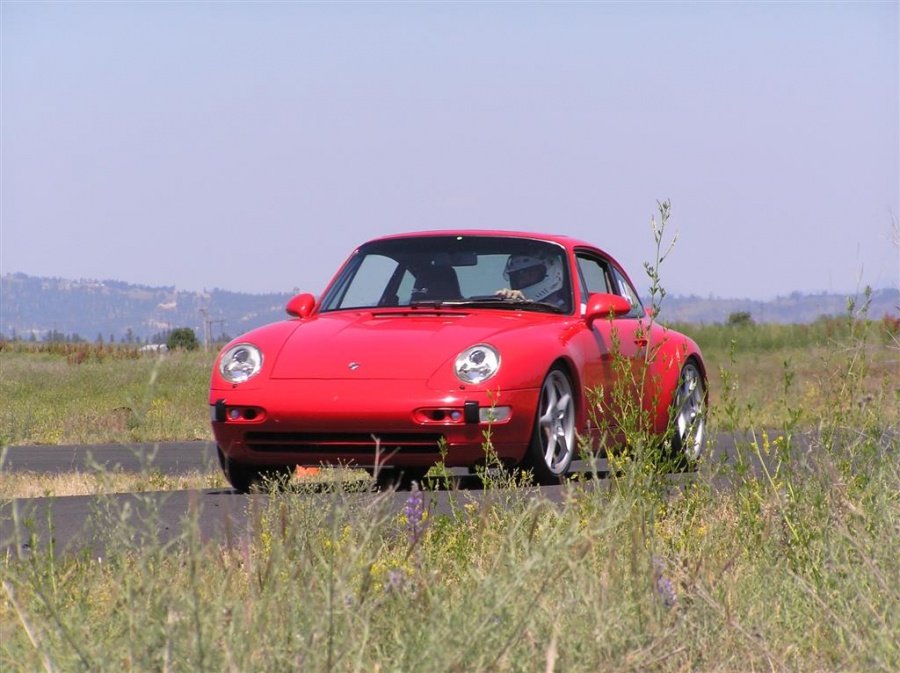

Mine does pretty good.. loves the excercise!
