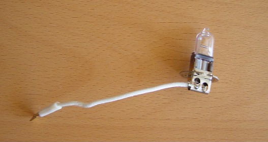

I have a quick question. I got my fog bulbs out... do you replace the whole thing? (see attachment) and its H3

Yup - you just snap the new bulb in - secure it with that wierd clicking latch and connect the cable - voila!!
Make sure you use a glove or or something as you are not supposed to touch bulbs with your hands as the oil from your skin can heat up later and cause damage...Besides fingerprints are nasty...LOL
