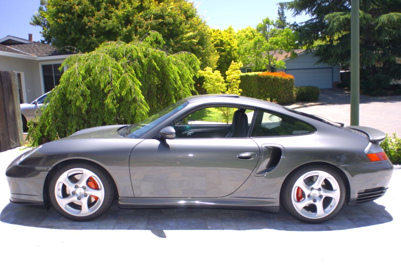

I’m pleased to report that with Stephen's tips yesterday I successfully installed the X73 suspension. Overall the car is 2 cm lower (OEM front lip was 165 mm, now it is 145 mm). Judging by the removal of the stock suspension and the installation of X73, the stock suspension is an afterthought for the US market. The X73 slips in easily and feels like it belongs there. The car looks lower though I still clear my driveway and my gas station curbs without scraping.
I took car for a short drive and my first impression is that the ride is almost as smooth as with the stock suspension but more responsive and with more controlled cornering. I still need to align the wheels in the next couple of days. Any recommendations for a good alignment shop in the San Francisco Bay Area?
