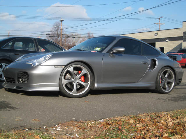

Here you guys go! As promised DYNO Graph.... and some pics as well...
Proto 600....
Proto 600....
Thanks for posting. That's a nice curve...smooth and steady.
