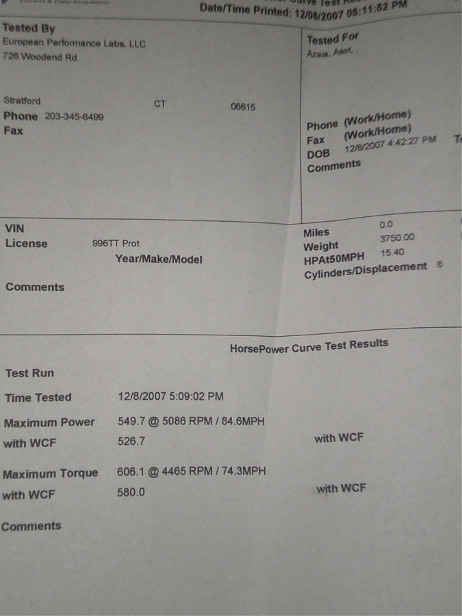

Went out to EPL in CT yesterday for the dyno day. Attached are the printouts.
549 awhp and 606awtq uncorrected.
The car did 3 pulls. all three runs were very consistant with results.
Weather was cold (i think 40ish deg), so i guess with correction factor the power gets corrected down. overall very happy with results.

john said that anything above 1.32 would max out the injectors and make no sense to do. also he said that AFR are good at 1.32 (obviously using race gas) and anything over will be inefficient.
one thing we noticed about the pulls (as you can see from graph) is that AFR arent the best (correct me if im wrong since im not an expert here). the guys at epl told me that its not the best AFR, but ok since im on race gas.
anyway i figured that my AFR were abit off since i was probably boosting higher than normal since we originally set the car to boost at 1.32 on a 70 degree day.
tony from EPL told me that as he was dynoing the car he saw 1.4 on the boost gauge at high rpms...
HOWEVER, driving home, on the highway, 3rd and 4th gear pulls i only saw 1.3.
anyone know why it would show 1.3 on the street, but 1.4 on the dyno. also, how do my AFR's look?

Yes, I think Tony is right. It is sometimes necessary to adjust your tune for altitude changes, temperature etc... I think if you have dialed her in you would have seen better numbers! I think Tony could have done that for you while you were on the dyno? Good luck and great numbers.

robmd: do you think numbers would have been better if boost was set at "ideal" 1.32 bar at those conditions? issue was that the greddy controller was far back hidden and it would have been a ***** getting to it since i have the gt3 seats/roll bar. would have taken forever.

I would safely run 1.3 bars on 100 octane. 1.35 bars on 104 and 1.14 on 109 or 110.
on C16 u can run 1.5 becasue of the gas...
ur maxing out ur fuel system - that is the reason for the high afrs... so turn the boost 2 clicks down to 1.3 bars and it will run 12.4s or so... where it should be.
if u took ur car to the same dyno on a warmer day ur current setup would have been perfect. Dont make a mistake that the greddy does it all for u. it will as long as u adjust it correctly.
on 100 octane u cannot expect miracles...
