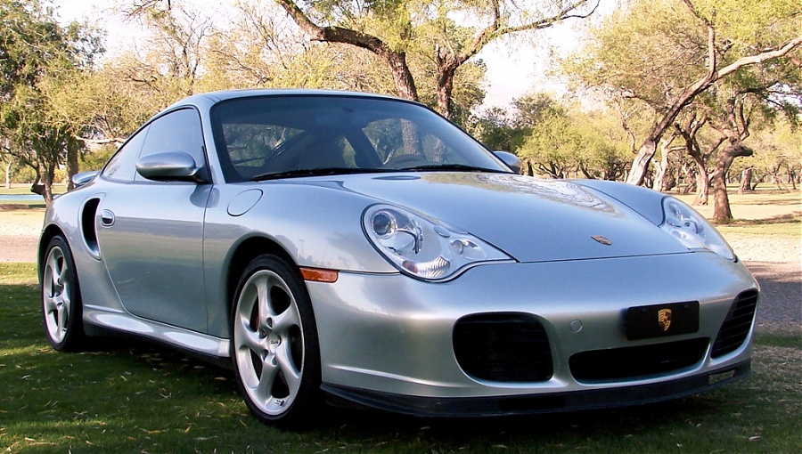

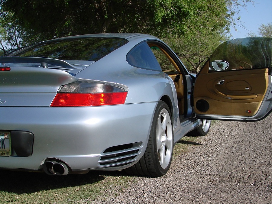

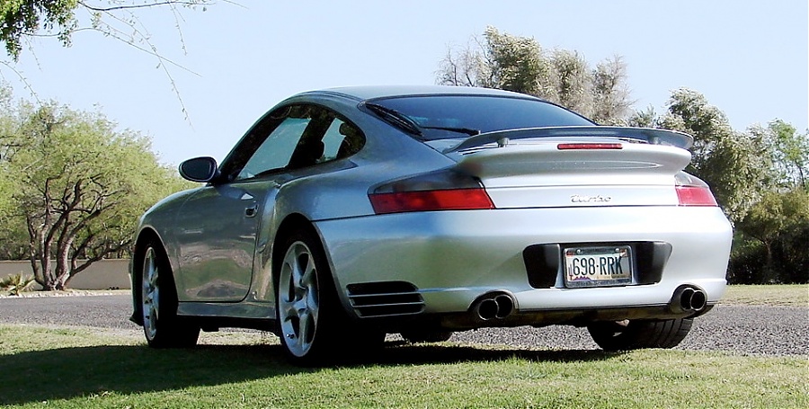

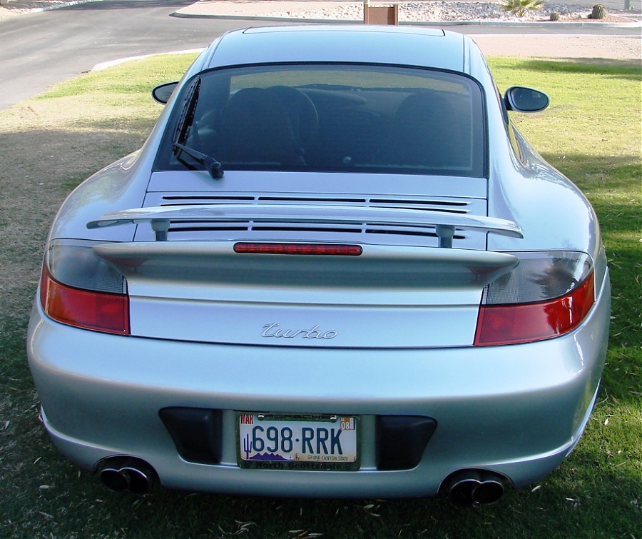

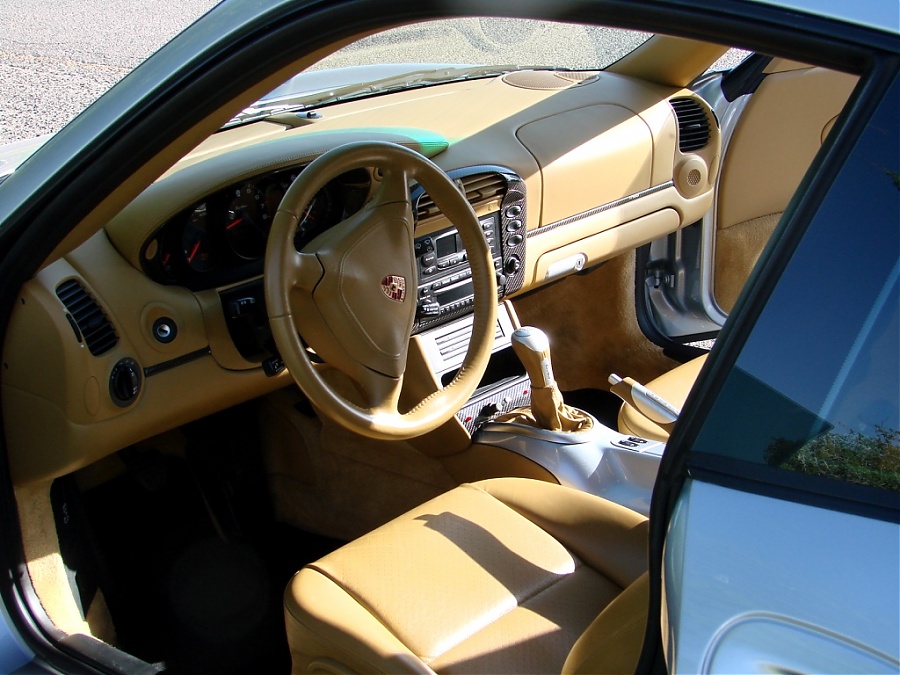

Update- Thanks- I bought the 996tt
Hi All
Thank you to all those that helped me with the Range 2 over-rev issue: I ended up buying the car. 2003 996tt Polar Silver with Sierra Beige interior; low miles; cream vehicle; CPO. My girlfriend and I drove from Tucson to Las Vegas up through rte 93- excellent, big winding road through the high desert- lots of visibilty, no cars- great apex's. Spent the weekend and then back to the Bay Area- Rte 58 also a dream. The car is a beast- I love it. My girlfriend was so smitten with the car, as soon as we got back, she bought a 2003 911 Targa- 6 speed; 12k miles; one owner. Beautiful, wonderful- and very different car.
Thank you cgard... for your kind PM- I couldn't reply because I don't have enough posts. I'll pass on your message to Bud.
Anyway- here's some shots. Name:  polar silver 996tt- rear -c.jpg
