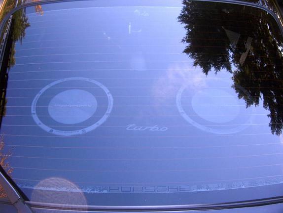

Good job guys. I always do my own installs. I changed out the deck to a AVIC Z1, built a 2 10inch sub enclosure with two 10 inch audio bahn subs, four sets of diamond audio mids and tweets with x overs, and jl audio 2 ways on dash. For amps I did a fostgate 1000a for the subs and a alpine 6 way amp for the rest. Its loud and hits hard. Almost forgot added a fared cap for wheh the bass hits
