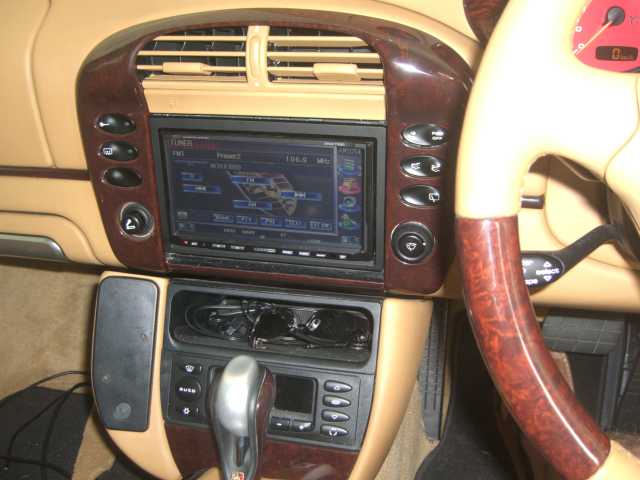

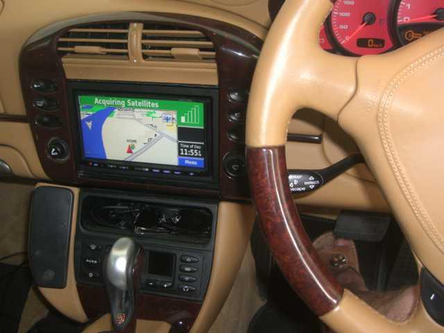

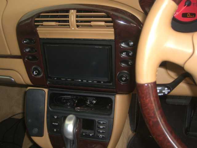

I thought I'd follow up with the results of my upgraded stereo install. I used the Kenwood DNX7100, and moved the a/c control to the bottom console. For this I had to purchase a new a/c control surround and new pocket from my local dealer. The a/c control is pretty easy to move (about 1 hour to do it), and I ditched the useless CD carrier as I'll be using a portable music player.
The double DIN unit needs some hacking to fit into the slot for the CDR and old a/c control position, but nothing too drastic. I screwed the DNX chassis into the plastic surround behing the facia once I had adjusted the height / depth for the DNX surround so it looks flush with the dash.
Patching it into the wiring harness was pretty easy, I did not find the right adaptors locally, but with a soldering iron and 2.5mm spades which fit the little sockets for each wire in the plug I built my own wiring harness and did not have to cut the car harness / plugs. The only thing to watch for is the remote amp switch on (Red/Black wire on C1) which goes to the remote amp control on the DNX. I installed the satnav antenna under the little alarm sensor panel at the top of the dashboard, so along with the flush fit of the DNX facia it looks very integrated and if you didn't know you would think it was a factory option.
One tip for people looking to replace the OEM Becker head unit and keep the stock amp and speakers is do not connect the speaker output of your new unit to the wiring harness speaker inputs. The DNX has line outs and having taken the stock Bose amp apart in the trunk, I could see that it accepts both line and speaker inputs on the same wire, and applies DSP and amplification for all the speakers. Using the line outputs from the head unit improves significantly the quality as it is not going through the head unit power amp to be amplified again in the Bose amp. This made an appreciable difference in quality and I'm now much happier with the stock amp and speakers, that I won't bother replacing them, especially as the 996tt is noiser than most when driving. You can also improve the quality of the Becker head unit the same way, by connecting the line outs from the back of the Becker unit to the speaker wires in the harness, but I have not tested this.
I have not seen this documented anywhere on this forum so this is my little contribution to this community
Two cute things I could do with the DNX, one was use a Porsche wallpaper JPG as a background, and another was hard wire my gate remote control into the spot where the satnav antenna and alarm sensor goes. The DNX has 2 external control soft switches that can be accessed via a hotbutton, so I now have integrated gate open / close soft buttons which work well. I had to add a little DIY electronics (relays and diodes) to make this work.
The satnav works pretty well once I upgraded to Aussie maps as I bought the unit Stateside and it only had US maps. The user interface is a little clunky but functional and easy to use once you get use to it.
All in all this took about 8 hours of work, most of the time futzing with dash to take it apart. I think I could do it in 3 hours if I had to do it again

Attached are pictures if you are interested in how this looks. I have yet to do the final adjust of height and fill a gap below the unit, but even now it looks decent & integrated, almost factory. It also makes the car seem much newer.
