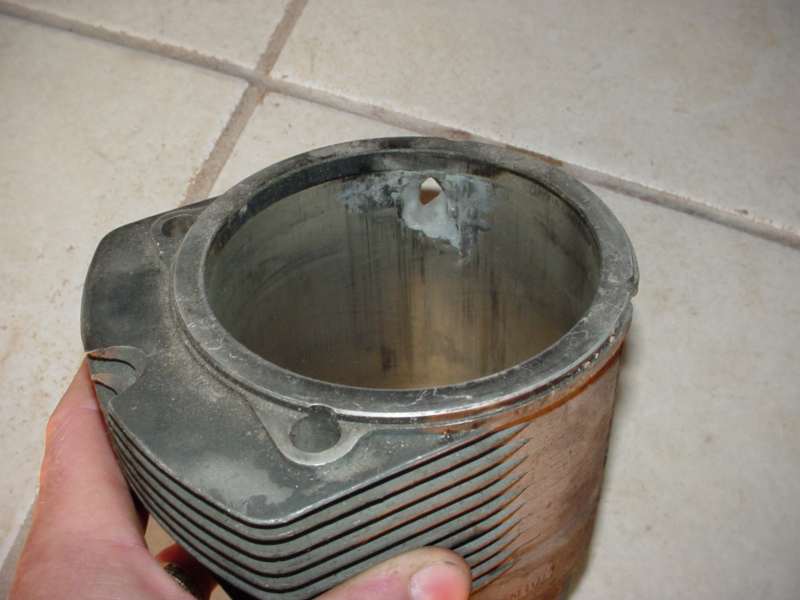

Here is a piston and cylinder what was on a motor. The stats were 3.4 Twin plug, aftermarket EFI system. The AFR was set in the low 12.-13.1 with nominal boost. The motor was only 22K miles into its new build when it did this. I didn't build it, but I did fix it for the customer and tuned it. Just thought you might get a kick out of this.

Piston

OUCH!!! So, what was the culprit that caused this? Running too lean (13.1)?

Sorry missed the other question. The AFRs on IV are about 12.2-12.5. this is a little on the fat side, but that is fine in my book
Yes, the piston in the picture was too lean. Was running moderate boost and moderate timing on pump gas.
I wouldn't call the hole moderate

Incidently, I have changed my plugs three times in 5000 miles just to check them. There has never been any sign of detonation....period. Stephen, I believe your above pictures are air cooled cylinders. Do you have one from a 996tt cylinder liner? Have you ever had detonation problems with a 996tt motor? If so what were the circumstances?

Yes, the piston was from an aicooled car, but the laws of physics still apply, and practical application to the street under daily use is not found in a book. I haven't had deontation because I don't run your AFRs.

BTW the piston in the picture was a twin plug set up with almost complete chamber burn and a timing of 22.
