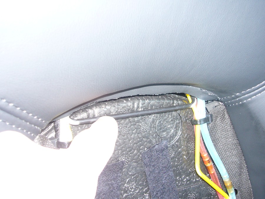

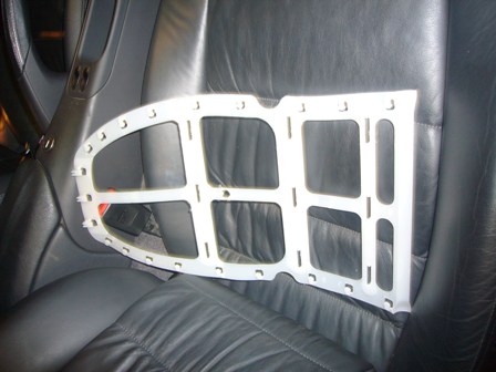

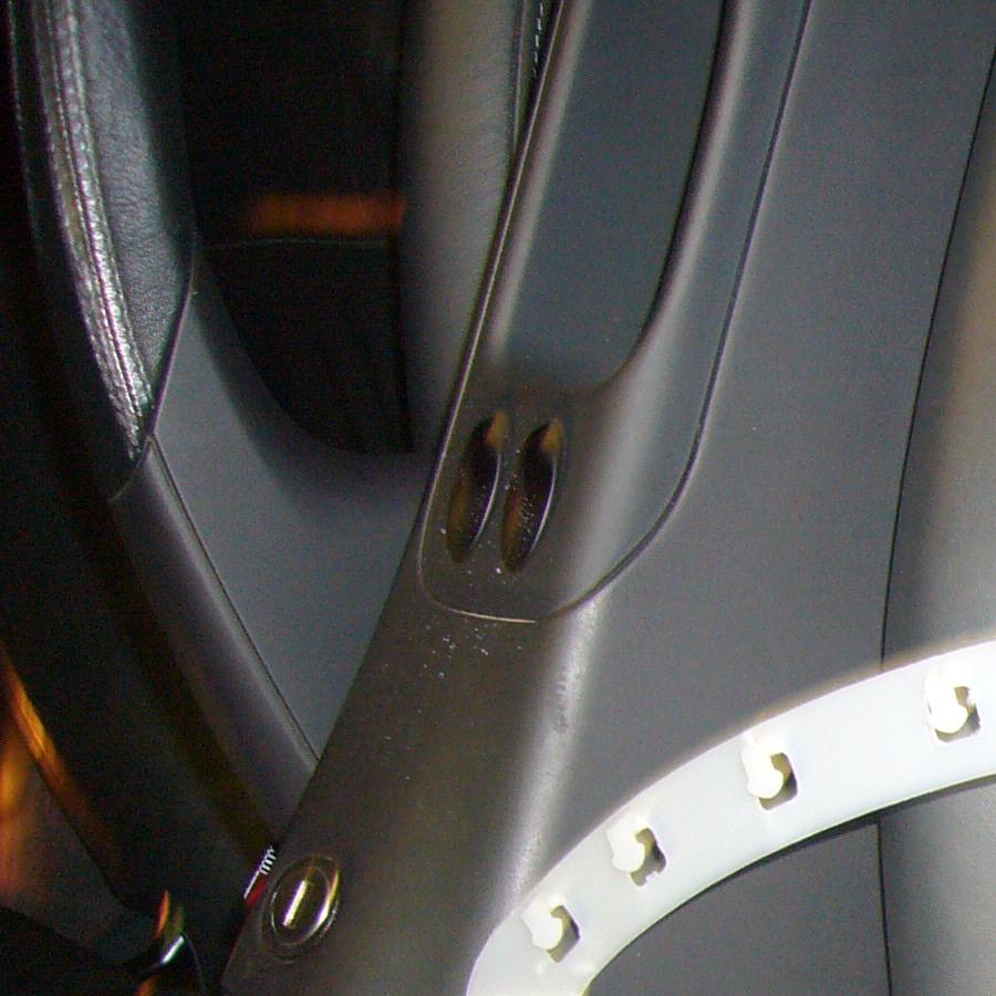

Hopefully these photos come up. As others have mentioned, this works no problem with supple leather. Just put 200 miles on the modded supple leather seats and they feel much better than the stock configuration.
To remove the metal clip binding the material to the plastic support frame, I used a pair of Park Cable Cutters (bicycle tool to cut bicycle cables). Took about 5 minutes to remove all 18. While putting everything back together, I used zip-ties. A few photos
a) The foam pieces, original on the left, replacement on the right
b) the plastic support frame
c) The seat open
d) Support bar the top 3 tabs from the plastic frame latch to
e) The top 3 tabs that latch to the support bar

ok, clearly those photos didn't upload properly...please hold.
Old Mar 2, 2008 | 08:11 PM
  #54
Freier's Avatar
Joined: Apr 2004
Posts: 436
From: Menlo Park, CA
Rep Power: 40
Freier is infamous around these parts
let's try this again...

Freier -- Thanks for the pics. Did you cut slits in the new foam for the transverse bars that are attached to the leather cover to go through? Did you take out both the grey and yellow/white OEM foam pieces together (I separated the white/yellow dense foam from the grey one, as Richard CH said)?
Old Mar 2, 2008 | 10:35 PM
  #56
Freier's Avatar
Joined: Apr 2004
Posts: 436
Rep Power: 40
Alpha,
On the first pass I didn't cut the slits, and I actually felt the "bar" across the back. So I then cut the slits to pass the bar through. I ran small zip ties through the holes used by the metal clips and attached to the plastic frame. Worked perfectly!
