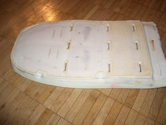

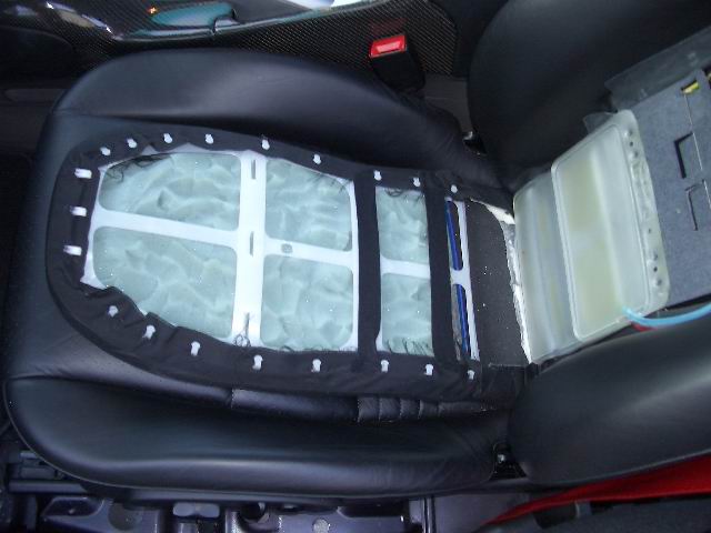

Today I discovered that you can un hook the OEM seat center section, Pic 1 yes, just lift it up and it angles forward. So I simply took out the large formed dense foam in there Pic 2 (which can be then reinstalled as you so wish) and fitted it with a cut piece of less dense thinner foam (already fitted in Pic 1)

nope the centre section just simply unhooks for maintenance access, just lift it up, bit of a revelation really ... get out in the garage and check it out

With the new foam, I just cut out the same shape from a foam square bought from my DIY store, its slightly less thick than the OEM foam you take out but more critically is much less DENSE which allows you to sink into the seat and take advantage of the side grip, its a massive improvement

top center section only, I separated the grey foam from the main support cushion (pic 2) and the inserted the new portion. Ps you need to re use the white plastic frame but I took out the metal rings previously attaching this
