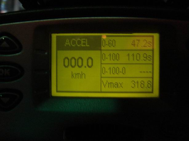

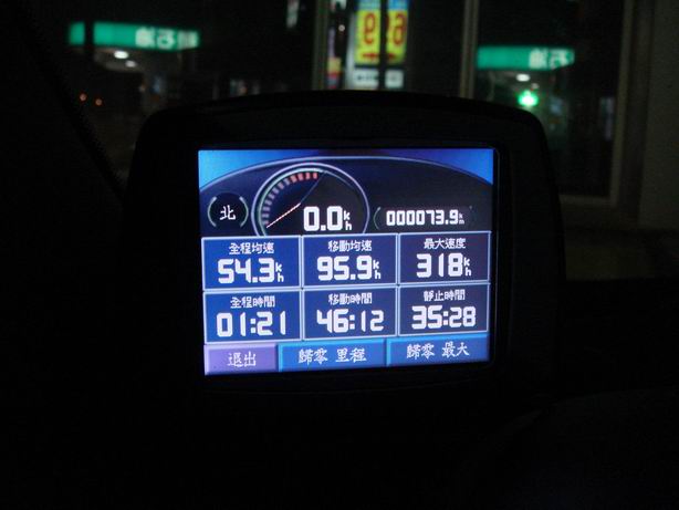

I tested it once with both D-Box & Garmin. It was 318.8 km/h according to D-Box. It showed 337 at speedmeter by factory hollow 18'. The whole set up was mainly under The Speedgallery Zero clearanne K16/24 @ 1.3 bar. You can see it's not reached the redline yet but I had to drop out for safty matter......

I guess it could be the difference of transmission.
Frankly, it is too dangerous to do this, for both turbos and engine. I only did it twice to test the limitation after mod, 327 & 337km/h.
I do tset 200-300 km/h more often with 16/24s or 24/18gs, the later did climb much faster but I wouldn't test the top speed any more.

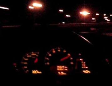

I've been a 178 mph (GPS verified) in stock 2002 carrera. It seems odd to me that a stock Turbo with 100 hp and 100+ lb/ft torque extra can only muster an extra 11 mph on top speed (per owners manual top speed of 189 mph). Is the factory conservative in its estimates?

1.2-1.3 bar with rev limiter at 7050 rpm.
341 km/h hitting the limiter on the speedo and 326 km/h with the gps !
Not bad ... !!!
