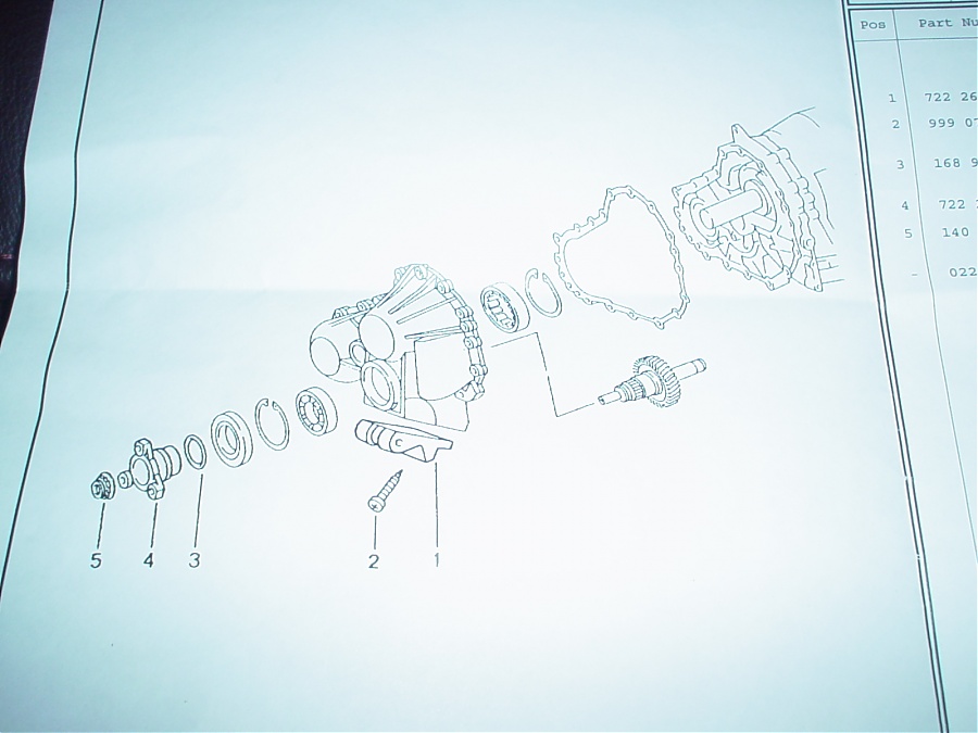

need some help from you guys, i need some parts for my car and my dealership is telling me that they can not order this parts and they don't have the program for installing or reparing this problem *** IT'S ONLY A SEAL !!! ***
what do you think guys ?
this is the torque converter or something like this ( i don't know how is in english )

The snap ring should be available anywhere, the gasket from Porsche. I would try another dealer if possible. If they can't take that apart I would not trust them to change my oil.......

not the snap rings are my problem, i need the big seal !

They need to look at a different diagram- the page you have shown only details a few pieces. There will be a different part/diagram which shows the cases/gasket...

there is not any more page about this part ! they said that this part is not for sale and that i need to buy a new gearbox

Hey Alex,
I looked all over the catalog, asked our head Motorsports guy, and our two service advisers, and believe it or not, you actually cannot get that seal and gasket separately. We've had to order an entire new transmission before because of that seal.
Crazy Porsche, I know....
yes i know that, they are crazy 15.000euro for a seal...
i will make it but i was hopping that in the US somebody made this seal but i see that i don't have luck, thank you very much !!

I am in need of these gaskets as well. using sealant is not an easy solution because the preload on 2 of the 3 bearings in the transfer case will be affected as they are tapered rollers. the last transaxle i pulled apart had a split gasket already and i may need to make one. or i can measure the thickness and remove shims from the bearing stacks.
i have exhausted the mercedes side of the parts spectrum and we do not use gaskets- only sealant in our 4-matic apps.
