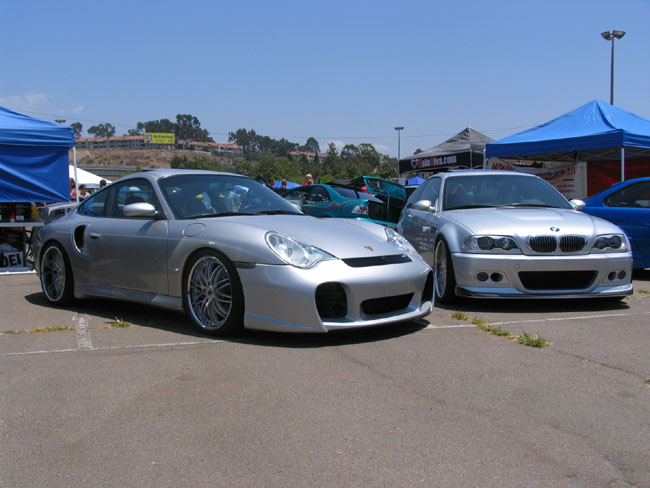

Hey guys- Just finished putting on my JIC coilovers, TE mode 20 wheels and GT3 sway bars. NO issues at all. I was reading all kinds of threads of people using gt3 front bar and having axle scoring issues/non adjustablility. Not over here, adjustable and fuctional. They went on just fine with the factory sway carriers and boy does this car stay leveled!!!
Since im not using the factory sway links, perhaps thats the difference. The front and rear sways definitely a plus!

kennytt, was that picture taking at the import car fest at Qualcomm?

dbelleperc- Yes that was at Qualcomm at the import fest. I was asked to be in a vendor booth for a carbon fiber company- even though I still have yet to put some carbon in the vehicle- lol

What are TE mode 20 wheels ? Never heard of em. Can we get a closer shot?
