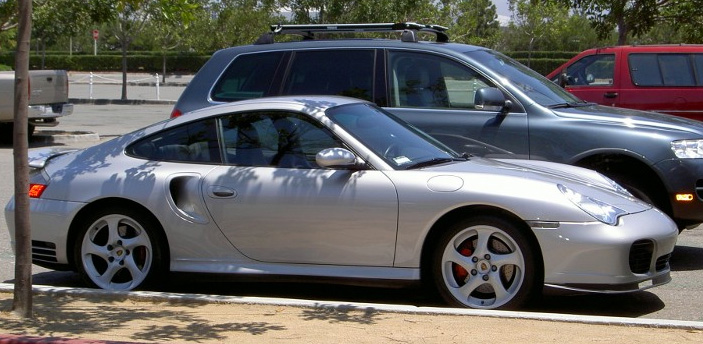

Here's a pic of the car before exhaust. Nothing to see but stock tips though. They do stick out too far like others I've seen also. I wish it looked more like stock.
No video clip with sound.....sorry.

Above pic is at Irvine Spectrum...Jake we should hook up and check out the rides. Would love to hear the exhaust.
