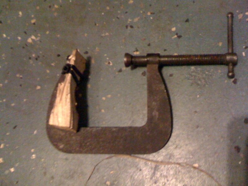

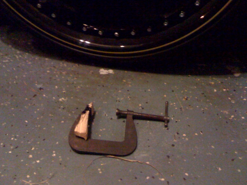

Well I made a little tool and got the clip in after 10 minutes of torturing myself.
In case your wondering...Its a clamp, 2 zip ties and a piece of wood I chopped.
