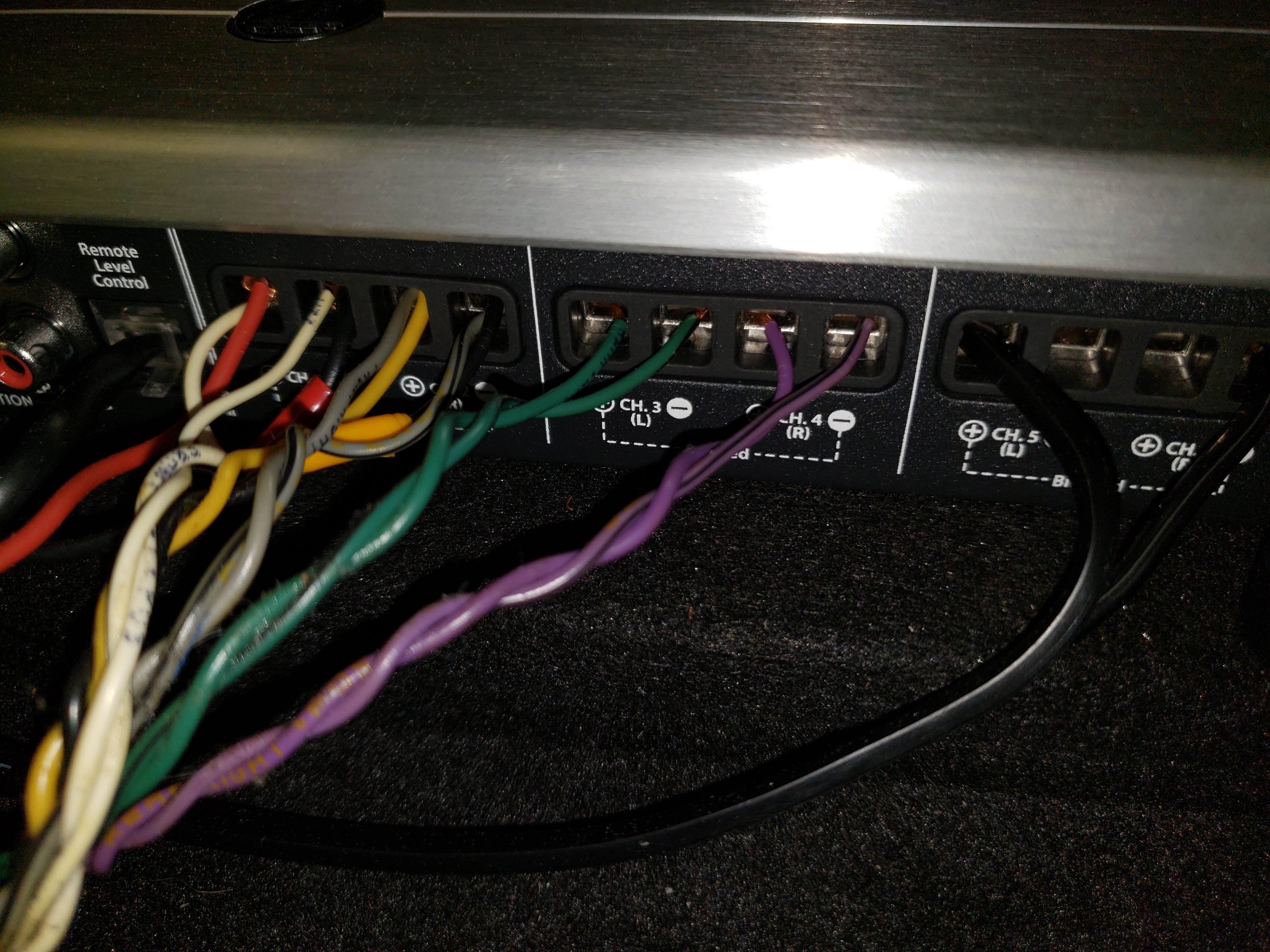

Isn't that the input side? 3 pairs of rca... there should be another bunch of wires coming out... that or your amp came with special wiring harnesses for each channel and the terminations are done downstream somewhere.
I landed my speaker wires directly on their respective channels that way I could tell what was going where, like this:

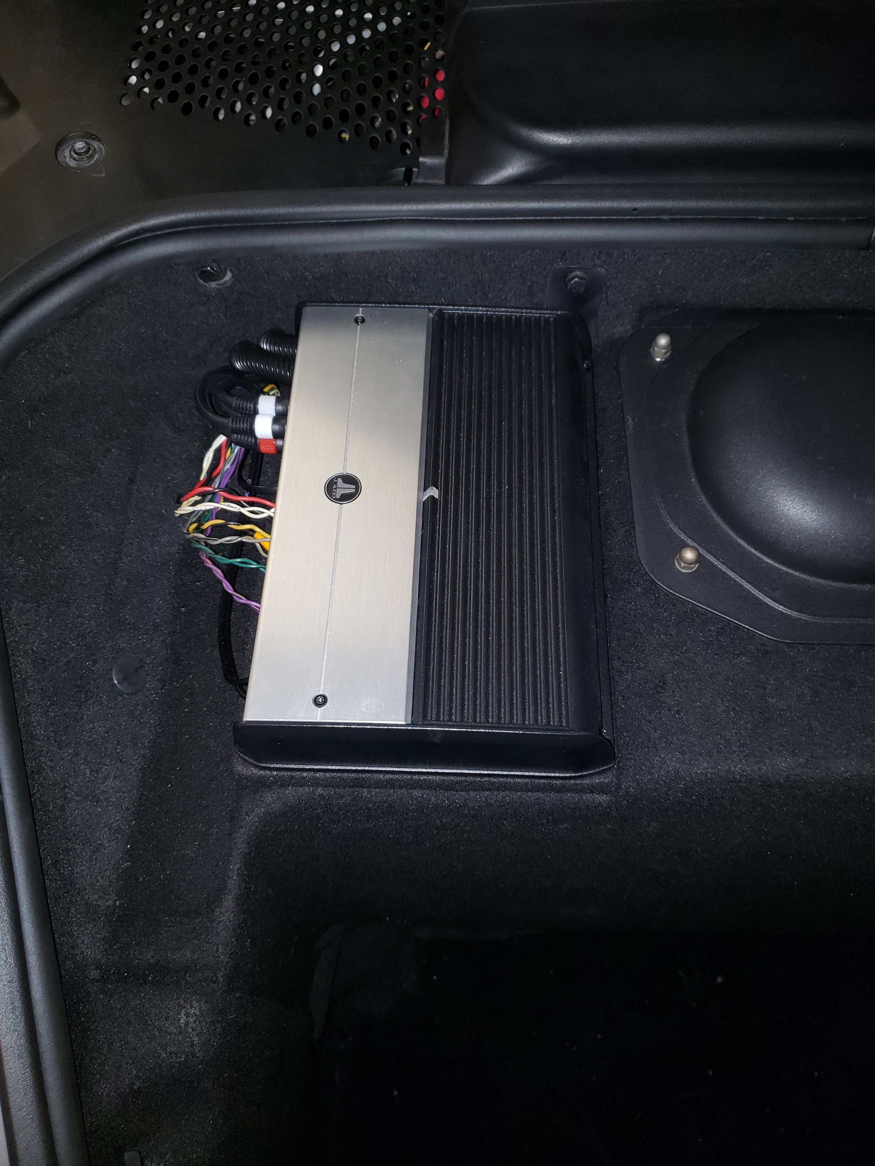

I'd like to see it, if you dont mind
I mean just zoomed out, such that I can see the wires. Want to see the install as it sits. I'm not asking you to tear it apart.
Something like this

Checking to see if you're still on. How did you mount that amp to the carpet area in the Frunk?
Something like this
Attachment 532255
Old Sep 7, 2022 | 01:40 PM
  #30
Stebo's Avatar
Joined: Dec 2015
Posts: 438
From: Jacksonville, FL
Rep Power: 53
Stebo has a reputation beyond reputeStebo has a reputation beyond reputeStebo has a reputation beyond reputeStebo has a reputation beyond reputeStebo has a reputation beyond reputeStebo has a reputation beyond reputeStebo has a reputation beyond reputeStebo has a reputation beyond reputeStebo has a reputation beyond reputeStebo has a reputation beyond reputeStebo has a reputation beyond repute
I'm still on... but when i switched back to apple from android, I can't find the damn forum in the app store, so I'm around A LOT less. Anyway, I made a custom mount using a piece of plywood that I covered in carpet. then, I bent some metal ( i think it was a galvanized simpson strap from home depot), drilled out the mounting holes, painted it black, and used the factory bolt and one of the attachment points for the CD changer on the fire wall. Unfortunately, my car is in storage at a buddy's house otherwise I'd run out there and take some more pics.
If you look close in the pic above you can see what i'm talking about. But yeah, totally custom. I got the carpet from a local car audio shop - thinking back on it - I had them use their spray glue and carpet to wrap it for me. It came out great. The carpet matches so well, that it is impossible to tell. I screwed the amp to the plywood and then bolted the plywood to the firewall.
It just sits there and is held in by the one bolt that you can see. It's totally secure and I drive like a maniac.
