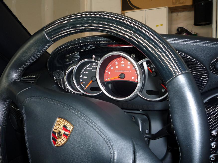

Anyone change the tach gauge to a colored one? want to know if its something I can do myself or if its very involved..

Do a search. I know it has been talked about. I did mine and it was not hard but not simple either.
Be patient and VERY careful as the gauge needles are sensitive.

You need to be real careful lifting the needles off. That is probably what Torres had issue with. The little gears behind there are sensitive. I popped on and was able to take apart the gear box and re-assemble. I did need a spare part for another I messed up so I got an old gauge set off eBay cheap and scavenged the part.
Like I said it is doable, just be patient and don't force anything

I did my tach last month... very easy.
When taking off the needle, use a fork under the round base and pry it upwards carefully.

IT was putting it back where I think I applied to much pressure
Like Joyride said, not hard but you have to be careful

I've done mine tach gauge too, be patient with the needle. Other than that, pretty straight forward.

FVD.de, they have clearance and able just buy the tach gauge face for only $71.

Yea its not a hard job, but as everyone else said be very careful taking the needle off.It looks great after its done and worth the chance...to me anyways
