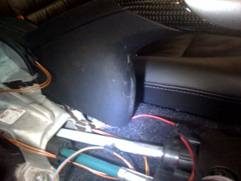

Hello all, I need some help. I've installed a Porsche OEM carbon fiber ebrake in my 996tt. The ebrake is rubbing badly against my center console. So much so that it's badly scratched the side of my ebrake. Am I doing something wrong? Is there anything I should look for? Thanks for your help, I appreciate it.

I'm at a loss too. I believe it's the correct console. When I bought my Porsche a few months ago this is the console that it came with. I don't know if you can tell anything from the picture but here is anyway.

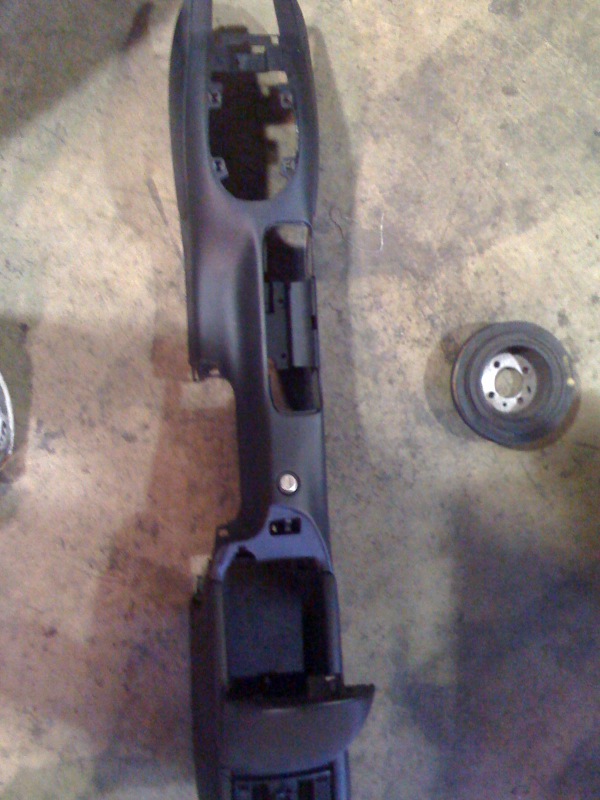

check the pic...
The red circle indicates where this green tab is located. If your console is rubbing your handbrake base, you most likely rotated this tab. (the tab is rectangular and can go inside the metal notch either way but only one way will clear)
If your console is rubbing after installation, remove, rotate and re-install the green tab.

ok, let me be a bit more clear on this...
You most likely replaced the handbrake assembly with a new one.
You took the old one from the car and installed the new one via the 4 screws that actually attach to the body of the car.
Then, after that's done, you need to transfer the green/blue tabs from your old e-brake assembly to your newly installed one. They are the anchor points for your console and they don't move your ebrake assembly in any way. Your ebrake is solidly placed on the car by now. This green tabs, when instaled in the wrong direction, will move the console anchor points 2mm towards the back, making the console too close to the ebrake and creating the rub. Those are the ones creating the problem.
I hope this clears up the installation process!
joel
