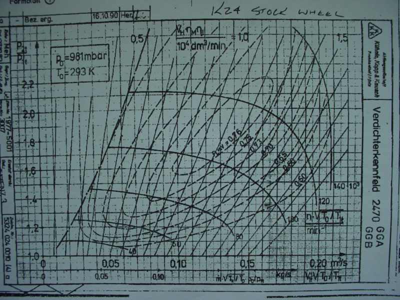

A K16 will not hold 1.3 bar through red line and if it is forced to you will pop it. The HP gain will be reverse since the unit is going backwards from heat saturation. You loose efficiency. There is a point where over spinning creates more air, but will also increase temperatures significantly because the design was not there to move that much CFM. The net result will not be the same. Smaller wheels spinning harder is not the answer. The key is to equal like boost with more air. My recommendation is to change over to K24s and have at it. Then again K24s will not like 1.3 bar either. They too will drop off the longer you stay in the RPM.

The map will tell you all you need to know This should make most scratch their heads.

Old Aug 23, 2004 | 09:57 AM

PorschePhd has a reputation beyond reputePorschePhd has a reputation beyond reputePorschePhd has a reputation beyond reputePorschePhd has a reputation beyond reputePorschePhd has a reputation beyond reputePorschePhd has a reputation beyond reputePorschePhd has a reputation beyond reputePorschePhd has a reputation beyond reputePorschePhd has a reputation beyond reputePorschePhd has a reputation beyond reputePorschePhd has a reputation beyond repute
This is the 24, I am looking for the 16. Not sure where I put it.
Can't read the CFM's but sure looks like 1-1.1 bar is all you want on the K24's
