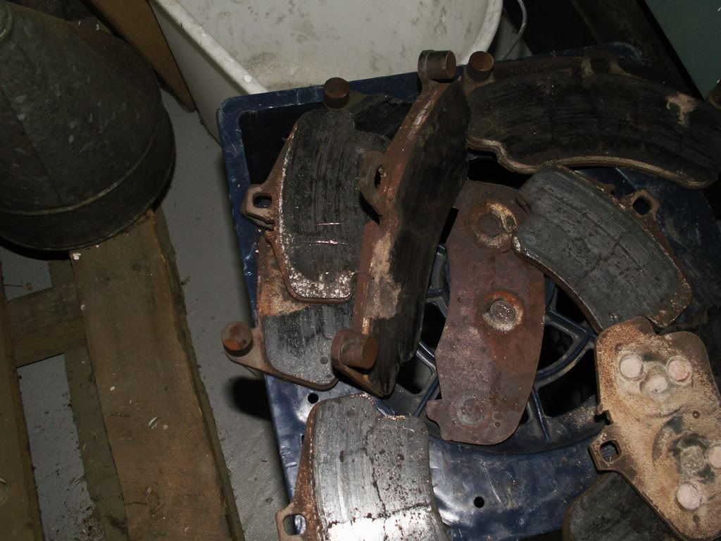

Pagid Yellows = no comparison!
Below pics show 15 track days in 7K miles on the rears and 9 track days and 5K miles on the front pads!

Old Oct 13, 2008 | 10:33 AM
angldrkns9's Avatar
Joined: Jun 2006
Posts: 2,240
From: NY & LA
Rep Power: 121
angldrkns9 has much to be proud ofangldrkns9 has much to be proud ofangldrkns9 has much to be proud ofangldrkns9 has much to be proud ofangldrkns9 has much to be proud ofangldrkns9 has much to be proud ofangldrkns9 has much to be proud ofangldrkns9 has much to be proud ofangldrkns9 has much to be proud of
mike, those pads look like they got a pretty severe beating
