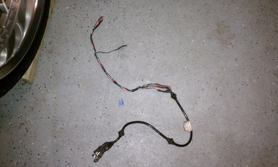

I am very happy to report that I finally ordered the part from Sunset. None of the dealers seemed to know what the part was or if it was the correct one and even the members on Rennlist weren't sure if it was the right one or not. Kind of surprised since it seems to be a VERY COMMON failure so the part should have been all over the place. Either way, the part number for the harness that goes from the wheel speed sensor up into the battery box is:
996-612-958-00
This is called a 'repair kit' for the right front speed sensor. It comes with the bottom plug that the speed sensor and the brake wear sensor plug in, then the wiring with all the donut mounts and waterproof cover and then the end is open with the 5 wires hanging all at different lengths so that when you attach it to the other harness, it isn't a huge BALL of crimps. It came with plug ends to attach to it, but I am going to use waterproof, heat shrink butt connectors to attach mine. I hope this will repair the ABS/PASM error I keep getting!!

I actually got it in the mail, made the post, then installed it since the car has been waiting for it the the front wheelwell and battery box disassembled. I'll take a picture of the part i cut out when i get back out there tonight as it'll just be a dirty version of what I put in there!

Here is a picture of basically what they give you. The one they give is about 2 feet longer than the one i replaced so you can have plenty of slack. Don't mind my hack job of my previous repair attempt!!
Lets see if I can get these uploaded here first, if not, i'll throw them on imageshack, but bear with me as i do it.
