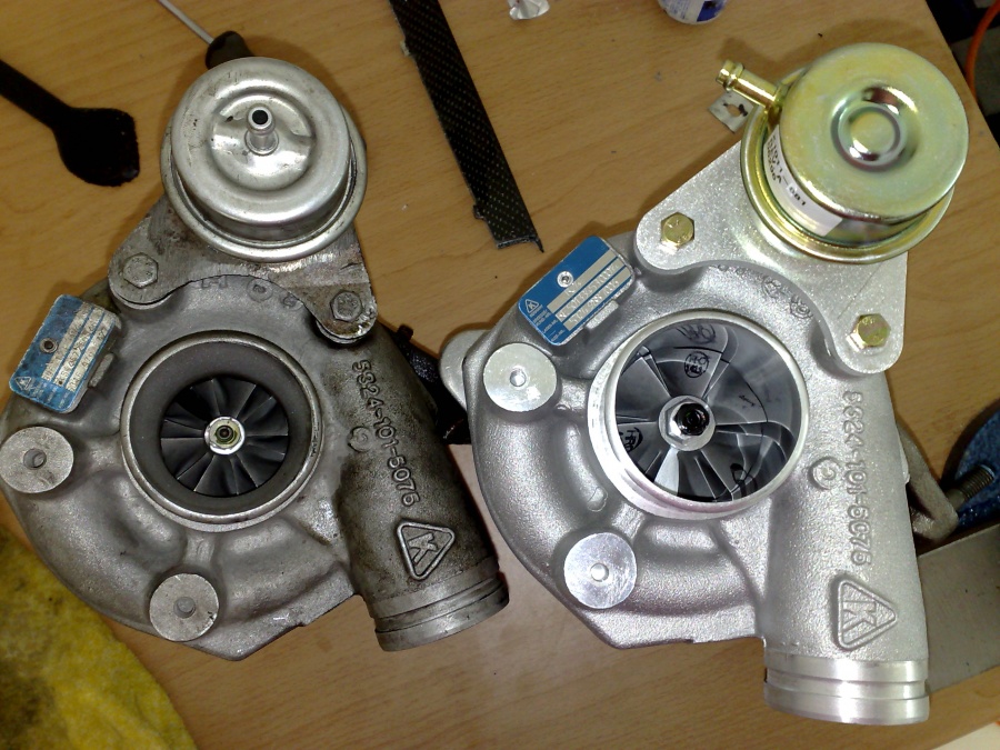

Can you see the difference now?
Ok, just to understand, i have never seen pictures of a K24/18 but it looks as a KKK compressor housing !
I thought it was a Mitsubishi compressor !
There are people here that machine the K24 housing to accommodate the Mitsu 18G wheel. This is a VERY popular setup here in the states. Great bang for the buck, especially if you already have K24's. About $1500 to upgrade including 1 bar wastegates, and then of course whatever your tuner charges for another tune.
Ah ok, now finally i know how it's made a K24/18 ... that picture explains many thinghs ... at least to me !
Thank you ... i have seen al lot of people touched by this discussion but sometimes one person wants to know how things work (that's for me) !
Maybe if i say that i'm looking to upgrade my K24's and i don't want to buy something wrong my discussion is clearer for everyone

Go ahead and upgrade your K24 to k24/18g...The hot side(exhaust)remains the same but the 18g impeller is machined into cold(induction)side of kkk k24 turbo...You ll love it...It reaches the limits of the internal parts...
