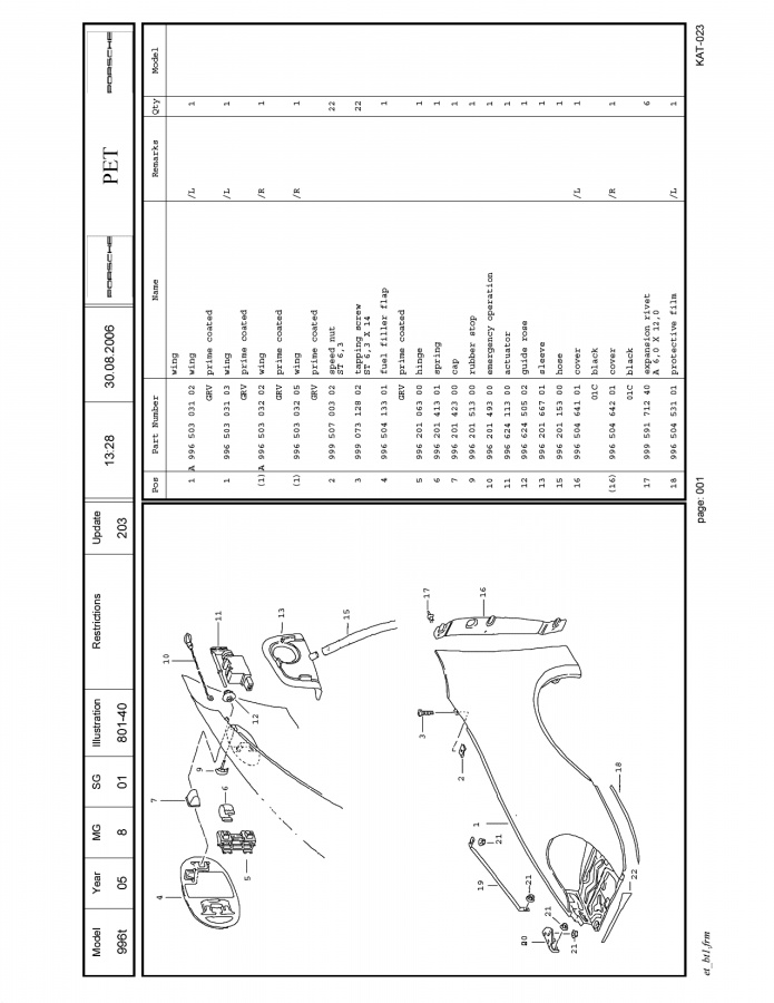

Actually, upon a second inspection, all it seems I need is the guide bushing (PN 997-624-505-00-M100 at Pelican) for 75 cents. From what I can see, it appears to click in to the hole in the body. Anyone know for sure?
Here u go

Picked up the 72 cent part today and popped it in. Problem solved! Thanks, all!
