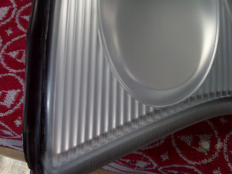

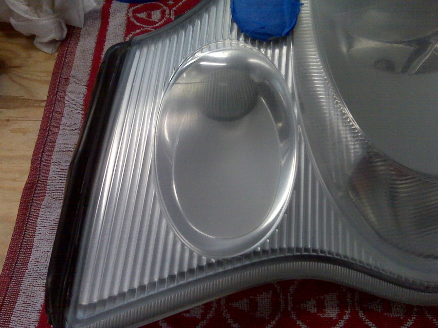

before photos
Originally Posted by scatman200
Pics would be greatly appreciated!
before photos

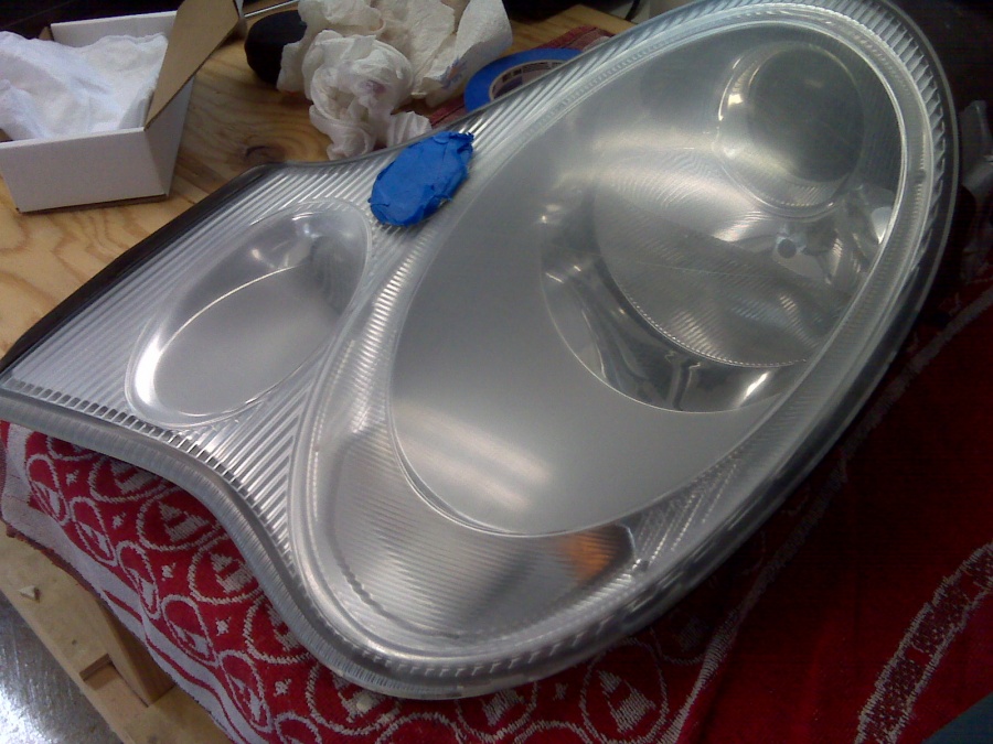

during photos
during photos

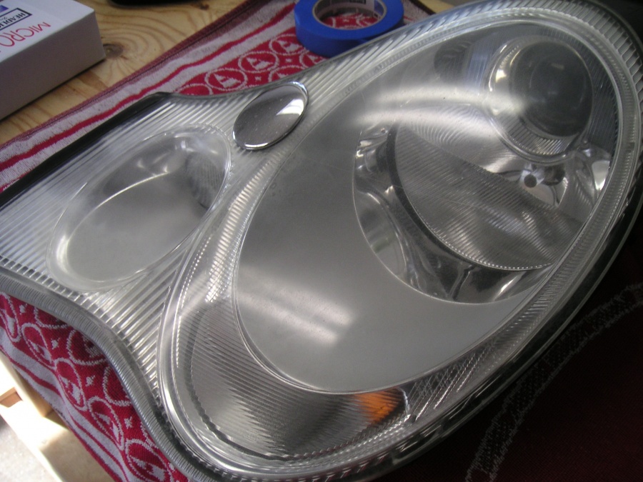

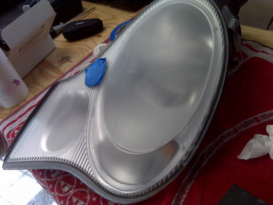

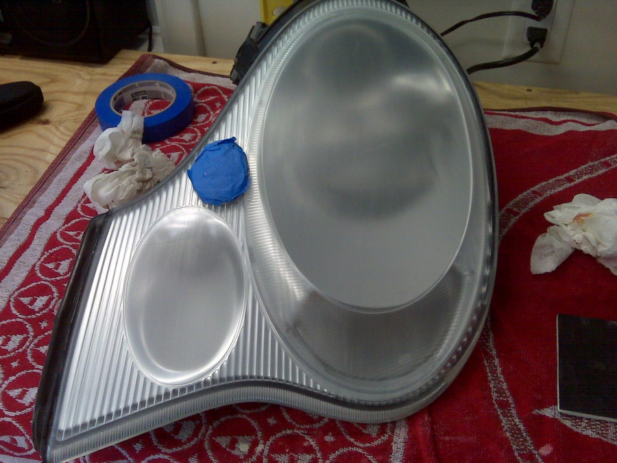

after photos
these after photos are pre-micro mesh polish and pre-3m x-pel clear bra, I'll try to take some photos of finished look today, but these photos are post all wet sanding
