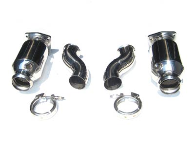

I am now the proud owner of lightly used, (and I mean lightly, these things are like nu). FabSpeed 996TT Sport Imported Racing Catalytic Converters with Muffler Bypass Pipes, but sans V Clamps.
I purchased the pipes used from a 6Speed Sponsor,
Pipe ID at Flange: 2.4" (ish)
Pipe OD at Flange: 2.5"
Flange OD: 3" as near as dammit.
Do you think I can find, or decipher which V Clamp that is compatible? Well depending on where you look V Clamps are based on ID of incoming pipe. OK, 2.5" right? Wrong! a 2.5" clamp expects a 3.2" or there abouts Flange OD and as they have minimum openings, this will not work.
Can anyone help?
Thanks
SWR

Get the OEM muffler clamps off a regular NA 996. They will work and they are a LOT stronger. You should be able to find them fairly cheap. I believe FS sources the clamps from an outfit in the UK, it looks like Tubi even uses them on their race muffler.

I have the same setup and also made the mistake and bought the wrong ones that were sized bigger... I got the right ones from ATP Turbo for about $16each.
http://www.atpturbo.com/Merchant2/me...egory_Code=CLA
V-Band Clamp - 2.50"
Heavy duty stainless steel V-Band clamp for turbo discharge setups or to mate (2) of our 2.5" v-band flanges. This clamp is made from Stainless Steel. 2.50" refers to the tube diameter and this clamp is used for industry standard 2.5" v-band flanges that have an outer edge of about 3.1". 2.5" refers to the outer diameter of the tube used on this size vband flange.

Back when I ran fabspeed stuff the weak link was always the v bands, they are weak and flimsy. The bolt is a 1/4" grade 5 bolt rated at 12-15 ft lbs of tq. trust me, after you loosen and tighten them a few times they are done, they will loosen and start to induce drone. The best option is the much stronger oem porsche 996 c4s muffler clamp with a stout heat treated grade 8 case hardened steel german bolt, run about 25$ a pr.
The rest of the FS stuff is decent, but the clamps are junk. Been there, done that, got the t shirt.

I somewhat agree, and for $60 a pair certainly not worth it. does anyone have the part number of the OEM Porsche C4 Clamp? Even though I do have 2 sets of the Fabspeed Style on their way. I they fail, I will get the good ones.
