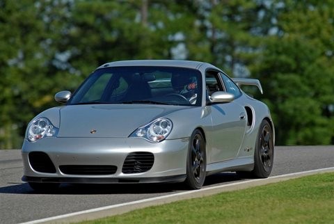

I run 17mm spacers and they make the wheels sit perfectly.

I run 17mm in the front with stock wheels/offsets in my pic posted. No problem at all unless you run a huge tire. Like a 245 front or something.
