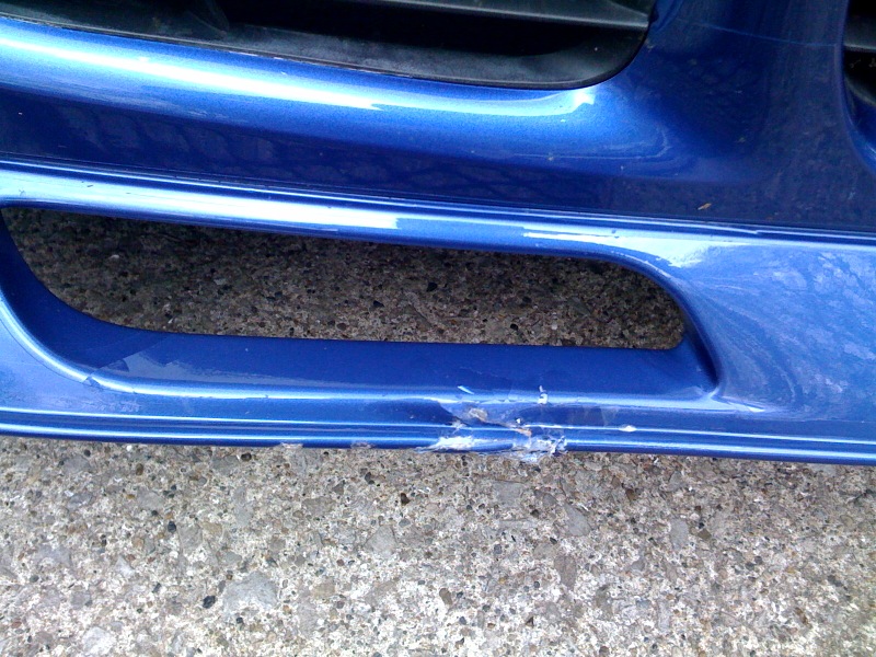

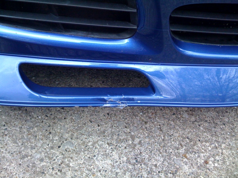

Well I was putting the TT on my trailer this afternoon to take the car down to my indie for the new UMW clutch & misjudged the incline. This is a brand new trailer to me & even though I thought the incline was ok, the front aerokit got %$#% up. I'm sure this has happened to others, but I am just sick about it. It doesn't appear to be cracked other than in the on place & that is more surface.
I'm wondering if a good fiberglass shop can repair/repaint the lower kit or is it going to need to be replaced.
I would appreciate any feedback.

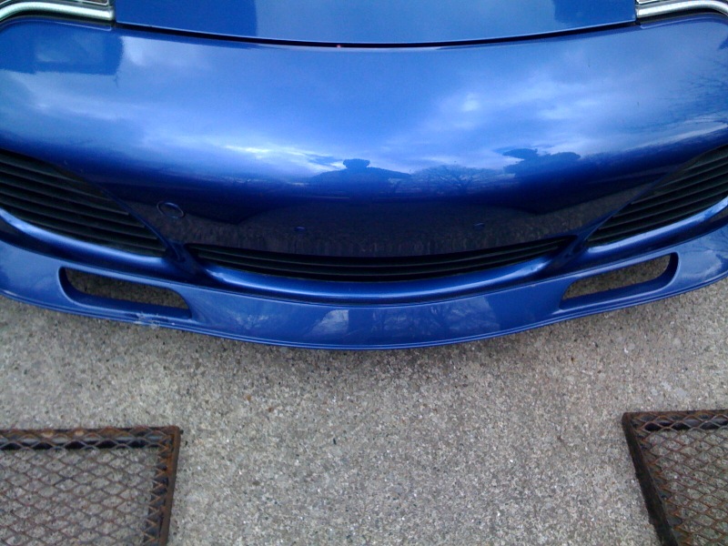

It is amazing how low these cars actually ride. I have a 18' open trailer with a beavertail backend. The ramps are 5 1/2' long & the car still bottomed out on the ramps. Doe's anyone have an easy solution.

A good body shop should be able to repair that.
I guess you know now to use a set of 2x6's as a runup. Some guys use one long one, with a shorter one on top to improve the clearance.
Sorry to see the damage.
Jon

easy fix with for a fiberglass guy.. he should make it invisable with little effort

I just had my car towed. The tow truck driver did a great job. See the picture of how he used planks. He never touched the car except the tow ring. I have three inches of clearance and a long overhang.

If that's an OEM front lip (polyurethane), fiberglass will not work on it. I had a few dents and dings in my front lip and my bodyman needed to add some poly on it. It didn't come out perfect b/c once the lip has a bend in it, it's near impossible to make perfect again unfortunately.

Thanks for the quick replies to everyone. I feel stupid that it happened. I always say that I need to slow down/think about what your'e doing when working around these cars. I've seen too many accidents/close calls with car + trailers. The lip is the factory Porsche aerokit. I don't think it is polyurethane, feels like fiberglass.

Edwin is correct. The OEM aero is not glass and will not repair very well. I had the same problems. I solved it by destroying the spoiler completely at the track and then replacing with FG. For a low approach angle I am successful by backing my tow vehicle up onto 10" ramps thus giving a favorable angle for loading/unloading.
