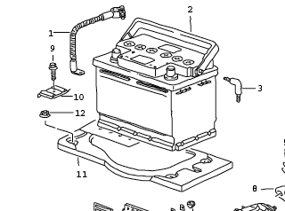

Replaced the OEM battery last night with a Diehard from Sears...while it was fairly easy to swap the battery, I am wondering, was there supposed to be any battery holder?
The Diehard fitted right in as dropped it into the slot...but there isn't any strap or holder there to really secure it, and I don't trust the cover will do any to stop a 40lb thing from moving around...is there really a battery holder?
