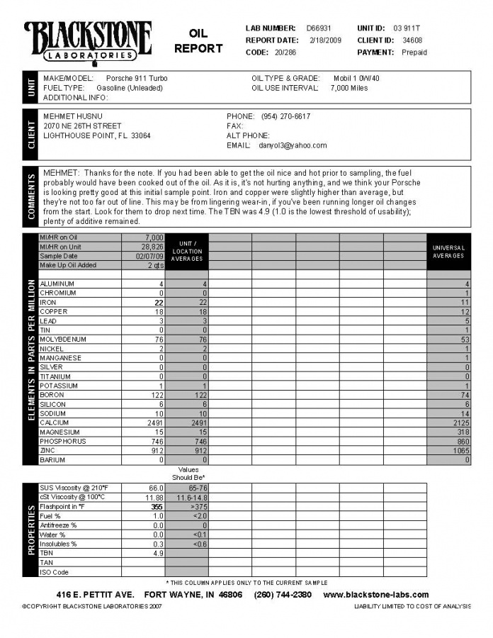

Hey guys.....I just got my oil analysis back and everything looks perfect. I put this oil in when I did the water/meth and EPL custom tune a few months back and it came out when I installed the EPL / Tial 3071s. So the oil in this sample was with water/meth ON and includes 2 track days.
I'm quite pleased with the results....see for yourself:

Had you established a baseline for that engine with Blackstone? That is where your engine can really tell the story.
I know for my airplane they say they would like to see three samples so they can track the trend.
Overall though looks like Porsche engines hold up well to lots of HP.

This was my 1st sample with the 996 so we can only compare to universal averages compared to previous samples....I send samples every oil change for my S4 and plan to do the same with this car. I will certainly share my data as I have it.

Have fun reading everything posted after page 5 or so. Many people on this forum unfortunately believe that meth will cause massive corrosion (completely false).
I think this oil sample is a HUGE win in completely debunking the idea that corrosion is even possible...

One thing meth most certainly does NOT do is foul plugs! More like steam cleans them! It's pretty tolerant of mixtures too, can run pretty rich.

Here's mine for comparison X50 no meth
