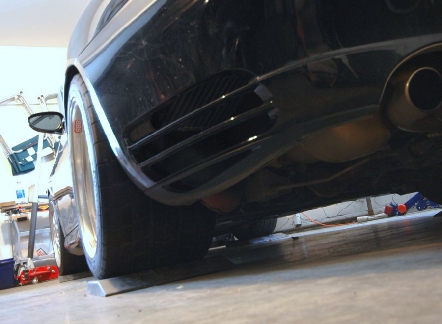

335/30/18's will fit. But they do need a bit of persuasion!

I ran the Hoosier R6 in 335 most of last season on my 996tt. I don't dnow how my offsets compare to GT2 spec but John at CCW would know my specs if you know yours. You will probably need to cut away a portion of the inner fender liner right in front of the compressor on the driver's side. I also cut away some in the passenger side but it isn't anywhere near the turbo on that side.

I do but also have -3 camber and wheel wells need cut out and fender rolled.

Have ran the Toyo R888 33's in the rear for past year, on street, low and on the track... No rubbing issues what so ever, our GT2's don't have the fender lining problem the turbo's do..
I will say this though, I went down to a 315 but now Hoosier R6, the grip is 10x better then the 335 in Toyo R888, may not even want to go up in size, but it will work!

Yup just like Zippy said, they will fit so long as you have a 12"+ wide rims and you cut the inner liner and roll the fenders which I did. I run neg 1.4 camber. I am stiill running RA1's but they won't be available much longer so R888's next for me. They are a great tire btw.
