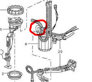

Got a picture of where this hose is located ?

Larry, I think it is #20

from what i understand... this white piece of tubing (rubber instead of plastic) is the weak link that usually goes bad..
It is either that one or the similar looking piece on the #20 from the above pic. I just remember they said the pump was pumping fuel back into the tank...
