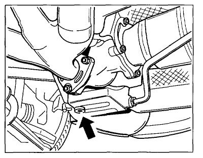

Here are the locations for the drain plugs (more for archives/searches):
one on each turbo:
