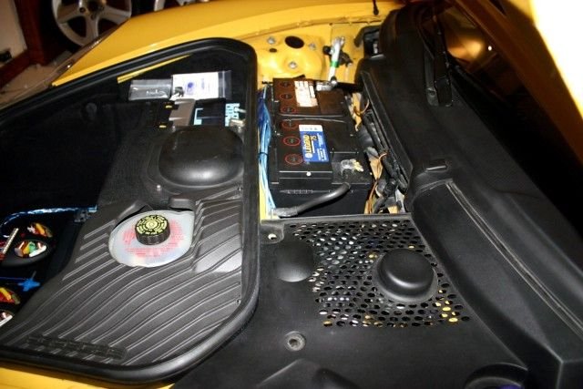

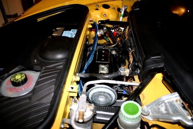

Sorry to resurrect a really old thread, but figured this was better than starting a new one. I've run the RCAs through that grommet that John show in the pic, but now have no way to get them into the trunk where the amp is. Any ideas that don't involve drilling a hole or tearing up one of the two harness grommets that are on the left and right side?

I don't recall exactly what I did, but I crossed over to the other side and went through an opening.

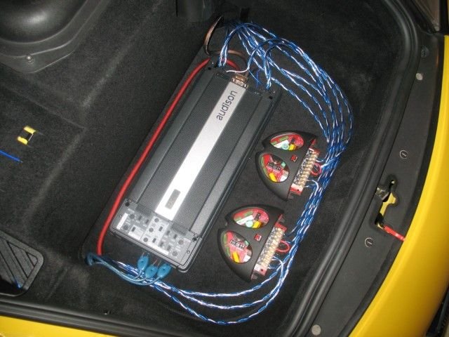

Here's a couple of pictures:

ok, cool. That's what I was considering doing. I guess I'll have to hack up that grommet on the passenger side. Thanks for the pics! Looks great!

You are correct, the best way is through that passenger side grommet. It is big and there is a lot of room for more stuff to go through it.
