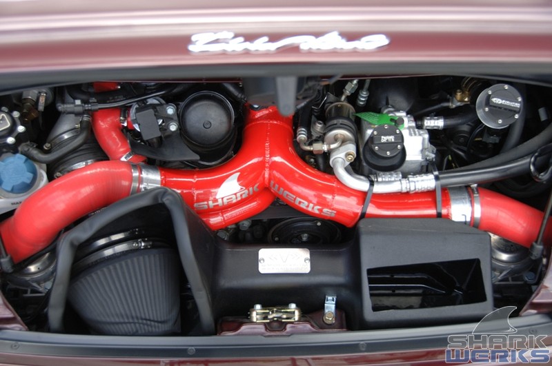

Here's my SharkWerks Y-pipe; pretty much 75mm all the way to TB and Plenum.

Looks great.
