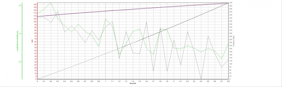

I installed the plenum/TB after I already had an EVOMS GT700 + ICs. My butt dyno checked out at about 625 crank hp so subjectively I cannot tell any difference after the plenum/TB. However, I can measure a difference with my Performance Box and I feel the gains are worthwhile.
Somewhat surprizingly, I can measure improved performance at the low end and especially at the high end of the power range. The midrange is surprizingly unchanged or maybe even a touch lower than with the GT700 alone. Somewhat concerned about the midrange I contacted EVOMS about some custom tuning for the new plenum/TB. Todd Z said that no tuning was needed. The overall improvement for my car across the whole power band is roughly 4-5%. At my level that is roughly 25 hp which is a little more EVOMS claimed it would be. The TB/Plenum has only been on the car a week so the ECU may adapt and improve performance slowly. (After the GT700 kit had been on the car for three weeks the high rpm performance improved 2% without having done anything to the car and outside conditions had gotten even worse for engine power ie heat & humidity).
Here is a P Box plot of 4th gear during 60-130 runs. The plenum speed line is red the non plenum speed line is blue. If you download the chart and look at it closely you can see the plenum is slightly but definitively superior to the setup without the plenum. (Conditions are roughly equivalent ie both hot and humid!!) As you can see the plenum reaches 130 mph 0.13s faster than the nonplenum. This only tranlates into ~2ft of difference in distance traveled by each car during the run. The third gear performance is similar but slightly less difference between the two. Most of the gain is in the upper rpms which agrees with the IPD site for modded turbos. This may not seem like much unless you are interested in bettering your 60-130 time. The plenum/TB gave me roughly 0.1s improvement in third gear and a 0.13s improvement in fourth gear thus dropping a 60-130 time by more than 2 tenths.
So should you get this for your first mod on a stock turbo. The truth is I dont really know because I never had one one a stock turbo. But my judgement tells me this is probably not the best initial mod. I still believe a flash+DVs+/- sport exhaust is the place to start. The k-16s probably dont move enough air to benefit much from this mod, imo. I believe its is a worthwhile mod on higher hp cars to improve spool time and high rpm hp.
