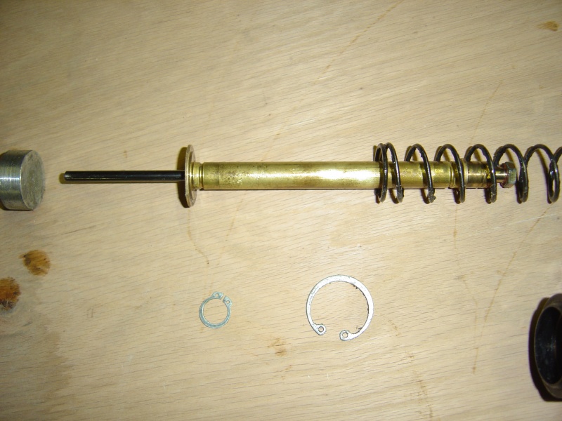

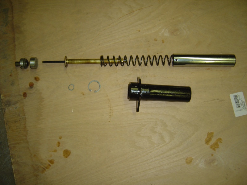

Yves, I remember a post from Webtool1, he was working on the spoiler system and successfully replace the seals on the spoiler actuators. Here's the pictures I kept from his post.
