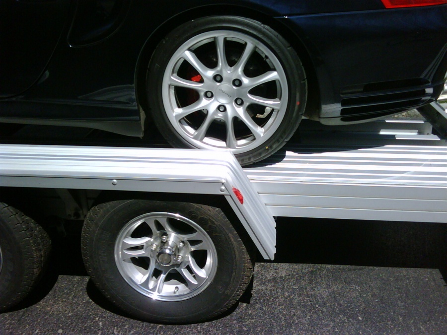

These are 6GT3 wheels with rear spacers...
