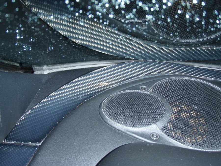

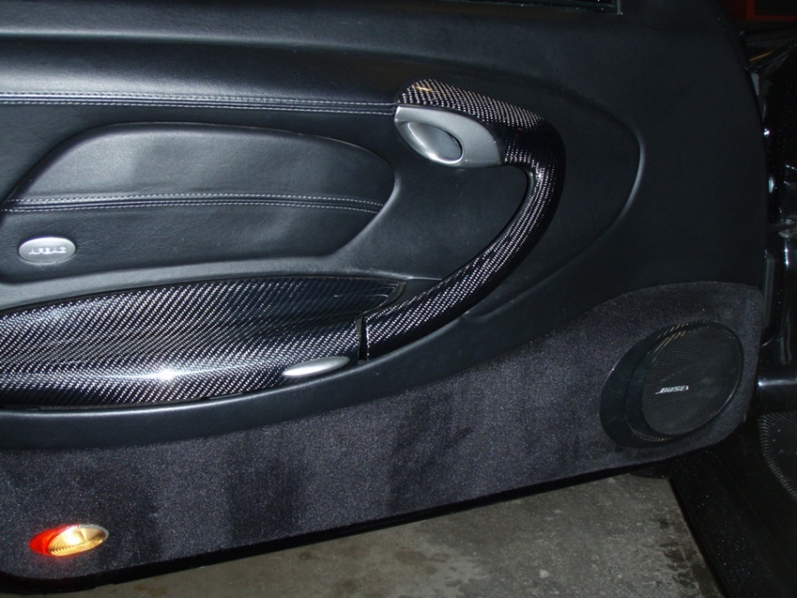

Well I may have the found the one pending the PPI. I do have a few questions. The dealer lists it as a 2001, but it has a lockable glove box. Wasn't this first introduced in 2002? Also, the carbob fiber overlay on the dash closest to the front windshield (where the dash and glass meet) is peeling up. Not sure how to rectify this. And then there is the wing and exhaust. Not sure what this means. More pictures to come. By the way, it has 59K miles. The price is right, even better if i's a 2002! Any other way to tell between the two years?

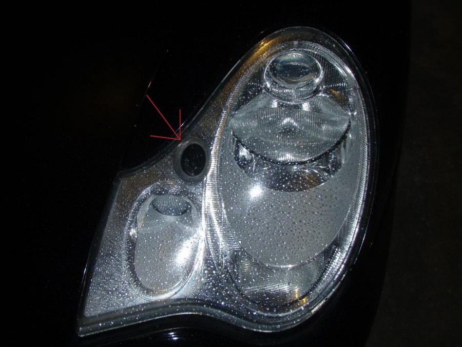

As promised...
The lights have a glaze on them. The delers body guy buffed this one clean, but also broke off this cover piece. Bummer.

exterior paint needed to be wet sanded and polished/waxed
new tires (very hard, but had polenty of tread)
light washer covers were borken (actually glued on)
Right Rear AC pipe was crushed along with some body rail damage (light)

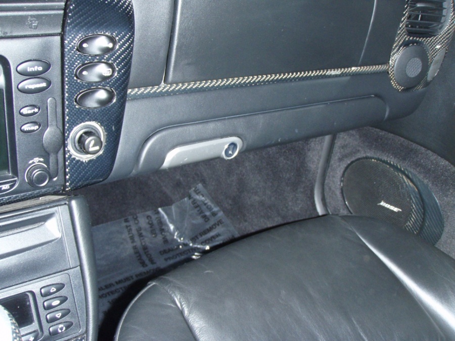

The carbon fiber interior trim on the dash is coming unglued
Passenger seat controls worked, but not well
Climate control screen was missing pixles

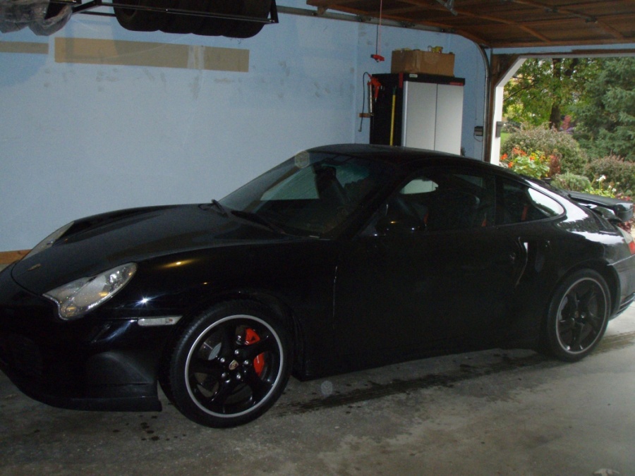

With the glove box, it should be 02 car. Check the sticker under the hood to show all options codes. It looks like a heavy options TT. Large leather package, large CF int. package, aero kit (missing front lip), nav, painted wheels. The fail of PPI was nothing major. It all come down to price.
