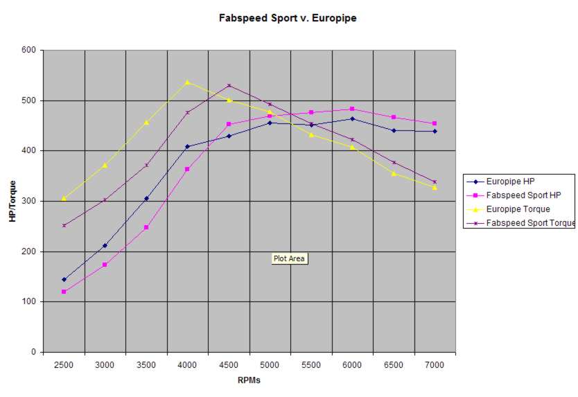

Zippy, the horsepower and torque curves above don't match.

Originally posted by Zippy
Stephen:
Thanks for your technical explanation of the adaptivve nature of the ECU. Your comment "Go with what works best for your needs" is the problem I face. My needs seem to be split between the 2. The Fabspeed shows the best power between 3500 and 6500 rpm. It seems to be the clear winner in that department. The EuroPipe has an exotic feeling about it and from what i read, a better sound and overall quality. In your opinion, is the smaller area under the curve in the EuroPipe a function of slightly higher backbressure? The flexability of the FabSpeed (bolt on straight pipes for the track) is very appealing!
BTW, just looked over stephen's exhaust test. Here are the numbers to 5000rpm's, although, I know you already have them.
Fabspeed Loud (hp and torque at given rpm)
2500--128hp/252lb ft
3000--190hp/332lb/ft
3500--271hp/407lb/ft
4000--384hp/504lb/ft
4500--447hp/521lb/ft
5000--461hp/484lb/ft
EP Stage 2 loud
2500--145hp/305lb/ft
3000--213hp/372lb/ft
3500--305hp/458lb/ft
4000--409hp/437lb/ft??(europipe said they never saw this kind of drop on their tests)
4500--429hp/500lb/ft
5000--455hp/478lb/ft
EP Stage 2 loud
I mentioned this drop off in a post when stephans test first came out. I asked anyone that had owned the EP exhaust and had noticed a 500 rpm off. No one responded. An extreme drop off of that amount would be very noticeable. You would definatly feel this. Not to discount the test but there is something weird about that EP graph. I have asked a few EP owners if they have noticed any 500rpm drop off and not one had noticed this.
Also the graph of the Ruf exhaust was strange also, when I had dynoed the Rufs with my other mods, it showed a much different graph than stephans. There is so many variables when dynoing, that can be schewed.

Well gang someone should have dropped me a call. Steff and I had already talked about this and confirmed that one of the wrong copies was posted, then sent and reposted. The corrected numbers for that range were 537 not 437 and the chart that is going to be published looks like this. Apparently the updated copy has not been uploaded. There were several drafts that were being cleaned up and doubled check against my notes. My office accidentally sent the wrong one. I should have noticed this in the original PP, but after 30 days of test, the heat and trying to work at the same time I glanced at it and said, UH Huh send it. So the graph below is the corrected version. I will also post another chart with the Fabspeed sport and the Europipe.

Fabspeed Sport and Europipe.
Thanks to the lovely Mrs. PhD for the chart

Thanks to the lovely Mrs. PhD for the chart! And also thanks to the lovely Mr. PhD for posting the correct chart. I have been mulling over the wrong data in my head since your research piece on the various exhausts was posted. It's amazing how having accurate data can make a decision that much more clear.
