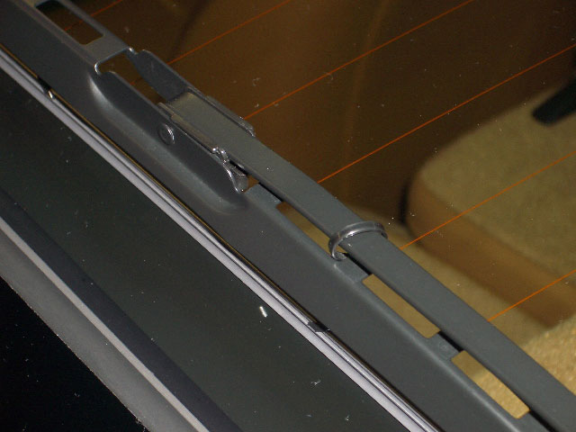

Zip tie rear wiper mod is the first mod any owner should do . Such a simple and discrete solution.

It only requires the wiper to pivot at the end of the arm with the wiper off the window. The aft end of the wiper blade is then over a painted surface. If the spring loaded arm is dropped then the blade end will scratch the paint. The wiper does not have to be raised very far.

The problem is the dealer's car wash jockey may carelessly leave it up, then let it fly when hit inadvertantly while wiping down the rear glass. Just do the zip tie for piece of mind. A few pennies saves hundreds in potential repainting costs as well as a couple grey hairs .

MKW,
You must have been reading my mind. I was just about to post the same pic.
https://www.6speedonline.com/forums/...&threadid=2772
