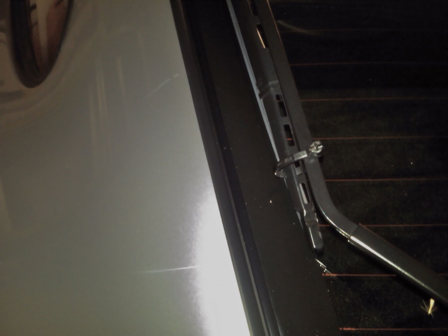

And here I thought that I was "THE only careless bafoon" that this happened too. Mine not nearly as bad as Ruiner's. Ouch!!! Thanks for the zip tie "fix." Have to wonder about PAGs engineering thought on this one. Support the dealer body shops?

Originally posted by BartN (TX)
Ouch! I would have vomitted on it immediately.
Good luck on the repair.
I'm thinking about carving my name in the 1/4 panel before it gets painted...

Brandon - My wiper scratches were as bad as yours. Once you get it fixed, and the wiper removed, you'll forget it ever happened.

Zip tie rear wiper mod is the first mod any owner should do . Such a simple and discrete solution.
Thanks. I wish I had known about this trick before I scratched mine. #*^@$%.
I'm going to zip-tie the damn arm tonight.
I'm going to recommend my Porsche dealer zip-tie every 911 they sell too.

that is horrid ruiner, is there no way it could be buffed out?
Negative.

Originally posted by oak
use a small zip tie to attach the blade to the arm. this will prevent scratches due to the wiper blade scratching due to the arm recoiling. easy and simple.
Thats exactly what I did, no problems at all.

Originally Posted by Ruiner
This is the work of the "devil":
Could these scratches be buffed out ? If i do decide to paint the q-panel.what about matching the silver color ?
